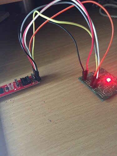

Can upload boot loader, cant program the chip !
Its 2 days now that i am dealing with this VERY strange issue .
I have a mac .
I also have a pcb with atmega328p,crystal-16M,capacitors and a led .
I am trying to program the chip using one of the 2 methods: an avr programer, an Uno as ISP .
both result with same thing : you can bootload the chip using arduino IDE, you CANT program it !!
So i connect all wires as required(i can bootload so i guess its ok) , than i chose from the boards the "arduino pro or pro mini" than i set the the programmer to be on of the two:
1.first try - arduino Uno as ISP
2. second try tiny avr programmer by spark fun :
In both cases - with the EXACT same hardware configuration , when i hit to bootload the chip it works, when try to upload a blinking sketch i get errors such as :
1.not in synch
2.cant open device modem 1421
So how can i bootload that same thing ????
Here is a log for trying with tiny avr programmer :
       Using Port                    : /dev/cu.usbmodem1421
         Using Programmer              : arduino
         Overriding Baud Rate          : 57600
avrdude: ser_open(): can't open device "/dev/cu.usbmodem1421": No such file or directory
ioctl("TIOCMGET"): Inappropriate ioctl for device
Please any help , would be appreciated! ( i read there is something to do with a baud rate ??? )
here is an image of the setup :
Looks like your mac docent even detect your boards serial port. Make sure its even detected. Could be problem with Arduino environment trying to use wrong serial port...
If you have a working ISP programmer you don't need the boot loader. Just upload your sketch with ISP.
