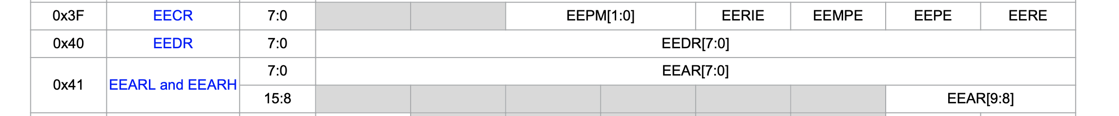

also could you please help me understand
what the value (range) should be used for address when we put this value for EEAR register
is the range between 0-1024 or need real physical address of flash like 0x03ff..0x04ff
if real address then what the range should be used for atmega328p ?

just need to understand what the range for address
You have 1024 EEPROM bytes on the ATmega328P
as you have more than 256 bytes, the register has a Low and High part and address ranges from 0 to 1023
I found in avr macros the end address is 0x3FF so looks like range is from 0 to 1023
but I cant understand the following
for 1023 is need 10 bits but according datasheet we have only 9 bits for address
Bits 15..9 – Res: Reserved Bits
Bits 8..0 – EEAR8..0: EEPROM Addres
in additional in the datasheet is written - "EEAR8 is an unused bit in ATmega328P and must always be written to zero"
so final result - we have only 8 bits for address = 0..255
??? Im confused
I think I had found in the past as well the doc with only 1 bit in EEARH butI found other docs and if you look at the image in my previous post you see bits 9:8 are actually used by EEARH ➜ so you get 10 bits total which is enough for representing 0 to 1023
thank you!
will try
