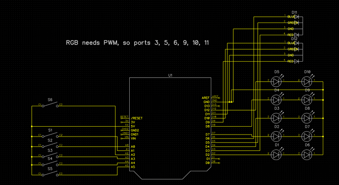

Ok, I will try to explain the purpose of the project. Again, I am very new to Arduino, so I appreciate your patience.
The project is supposed to replace this.
It is a lockout buzzer system that shows who was the first to stand (5 quizzers) and keeps anyone else’s input from registering. Quizzers can jump (the mechanics of jumping don't really matter; by jumping, a circuit is connected) which sounds a tone, and an LED turns on to indicate to the quizzers and to the "Quizmaster" who jumped. The quizmaster hears their answer, then determines if it is correct and the quiz moves on to the next question.

@Paul_B Each LED must use one digital pin (x5 + 2 4-pin (one ground) LEDs for a total of 11 digital pins), the seat pads use 5 analog inputs, and the switches to disable the seats. The switches can be in series with the inputs from the seat pads, but that's a total of 16 pins of which the UNO only has 14. I'd be interested in another board, esp. with IoT or something, but I don't think I have a choice.

That is a somewhat confused description. 12 single-colour LEDs in a matrix is seven pins. 12 RGB LEDs in a matrix would indeed be 12 pins but 12 (or 24, 36 etc.) WS2812 individually addressable any-colour-at-all LEDs all connect to only one pin. :face_with_raised_eyebrow:

Well, I had all of this typed out, and then I made an actual schematic and... um... I'm not sure where I got
from. With all 5 seats, 5 addressable Single colors LEDs (with each address controlling 2 LEDs), and two 4 pin RGB LEDs, that leaves me with one to spare... I can use UNO. I wouldn't mind having some more spare pins to add more switches, but it looks like I can use this.
@dave-in-nj Thanks for suggesting making a diagram... that saved a lot of time.
