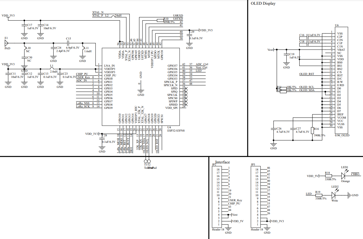

I tried the u8g2 example and now i uncommented the right line (sorry for being so stupid XD). I changed the SDA and SCL to 21 and 22 but it wont work. I looked in the schematic of the OLED display and it says that SDA and SCL are other pins, but these wont work either.
Here is the schematic, maybe you find something:
I cant get any example of u8g2 library to work...

Can you try with 17 (SCL) and 18 (SDA) ? I took those numbers from the schematic that you show. I even had a link to the schematic in post #10.
Perhaps the Heltec library uses pinmapping somewhere in the initialization code.

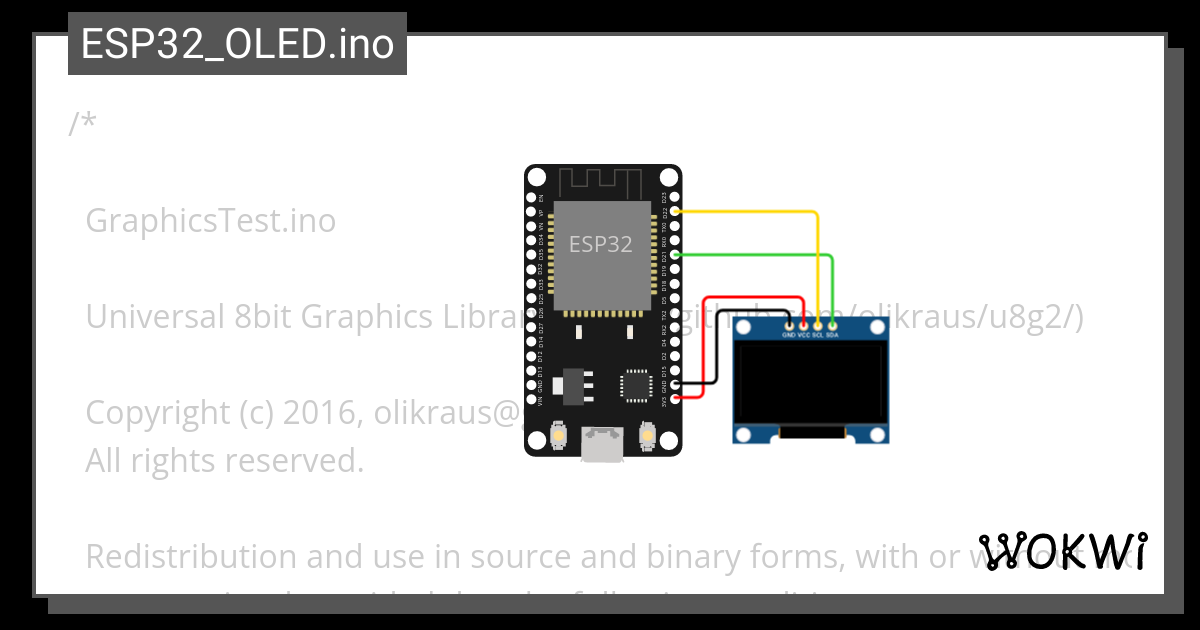

Let's do something funny :partying_face: This is also an example from the u8g2 library: https://github.com/olikraus/u8g2/blob/master/sys/arduino/u8g2_full_buffer/GraphicsTest/GraphicsTest.ino
When I put that in Wokwi, it works with either one of these lines:
  • U8G2_SSD1306_128X64_NONAME_F_HW_I2C u8g2(U8G2_R0, /* reset=*/ U8X8_PIN_NONE);
  • U8G2_SSD1306_128X64_NONAME_F_SW_I2C u8g2(U8G2_R0, /* clock=*/ 22, /* data=*/ 21, /* reset=*/ U8X8_PIN_NONE);
I haven't tried pinmapping for the I2C pins. The Heltec board seems to use that.
The Wokwi project:
I already tried each of the two lines with the 17 and 18 Pins for SCL and SDA but it didnt work before. Until now the display only works just with the heltec library, no other lib works....

With pinmapping I mean that the hardware I2C bus can be routed to other pins.
@furti04 Sorry for being late, as i understand your board Is the Heltec WiFi kit V3 version. This board does not yet support the u8g2 library (due to my poor knowledge i didn't understand the reason why).
Try to replace the u8g2 with older version of the library u8x8. Tested with the same board, It worked.
The solution to your problem is the pins changed in the V3 board. CLOCK = 18, DATA = 17, and RESET = 21.
This YouTube video DavesGarage used the earlier version, but in the later comments someone calls out this solution in the comments 3 years later.
OMG thank you! I was following Dave's Garage. You found the pins that I've been looking for for hours!
