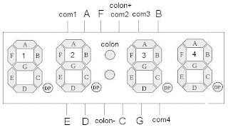

I don't know. But I found this picture somewhere, and it is the same model.
It shows all the pins.
That doesn't answer the question. You can't tell by looking at it. You have to have the right datasheet or be able to test it yourself. Do you have a multimeter?
You can test it yourself with a 1K resistor and a 5V power supply.
TOP-CA-5461BS is common anode. It can work with max7219 but it will not be straight forward as with a common cathode display.
Because the display is common anode, you will not be able to use the setDigit() or setChar() methods of the LedControl library. But you can use the setColumn() method if you provide your own bit-patterns for digits 0 to 9.
