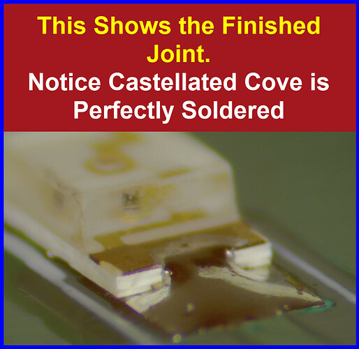

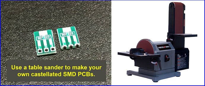

See these posts.
> [@Share tips you have come across](https://forum.arduino.cc/t/share-tips-you-have-come-across/428745/713):
> If you purchase a board like a Buck Converter 'and' the board doesn't have components on one side, you can use it as a Castellated daughter card on a PCB you design. Use a table sander to take off the edge(s) of the PCB where the through solder holes are located. For insulation/isolation purposes, place Kapton tape on the flat underside of this PCB. When 1/2 of the buck converter hole is removed, solder the remaining plated through hole to the motherboard's pads. On a none castellated edge, …
 ![image](https://europe1.discourse-cdn.com/arduino/original/4X/d/9/9/d99fe4c8b4987499338326d528cb238ad74a4453.jpeg)
> [@Share tips you have come across](https://forum.arduino.cc/t/share-tips-you-have-come-across/428745/1069):
> Hand Soldering Castellated Components It can be difficult to solder castellated components as the area to the left and right of the cove is, usually, glass epoxy. If you follow the images below, you should achieve good results when hand soldering these devices.
 ![image](https://europe1.discourse-cdn.com/arduino/original/4X/f/f/5/ff520b6488766f3026000b4e431351723c2ee1be.jpeg)

![afbeelding](https://europe1.discourse-cdn.com/arduino/original/4X/5/d/7/5d771f1421d1f283a726069e13ff91f8b2939633.jpeg)
Had to cut away an led and resistor. They didnt seem important 🙈
I cannot recommend this machine. It is hard to it straight without an extra tool. I just did it by hand and eye vision (and yes I wore me goggles)
 ![afbeelding](https://europe1.discourse-cdn.com/arduino/original/4X/e/9/f/e9fced94f43277cf5ccb494c0b88df678fda350e.jpeg)
 ![afbeelding](https://europe1.discourse-cdn.com/arduino/original/4X/9/5/1/9511d24c97a8be2f6105ee25fa395abeeb88b3a1.jpeg)
 ![afbeelding](https://europe1.discourse-cdn.com/arduino/original/4X/d/b/2/db2e145f58d3b73e5a318b233e36c3f65b96925c.jpeg)
 ![afbeelding](https://europe1.discourse-cdn.com/arduino/original/4X/6/4/7/647f57bcd4cda98ee68ef5be5e82c8d331a3cb9d.jpeg)
I almost lost pins 6 and 10 🙈 Sanding does work though
The copper is now exposed. If I solder all the pads (and the remains of pads 6 & 10) completely so that no copper is exposed will it eventually still oxidate and 'go bad' or can I expect alteast 10 years of loyal service?
Another question. The bottom side shows me 'the simple', '5v' and 3 different clock frequencies. Judging on the 5V I think this is a 5V variant. Those clock frequencies (8, 16 and 20MHz). Can I select any of them in the IDE? The tasks only exists out of reading some switches and control some LED. I do want to use SW serial libary for B2B communication. I'd prefer 8MHz in order to reduce current consumption.
Nvm found the fuse settings in the IDE

Make sure when you solder, that the solder runs the full depth of the opened plated through hole, to make sure you cover any cracks in the plated surface.
A good resin cored lead based solder.
Tom... 😃 👍 ☕ 🇦🇺

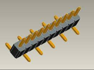

I have another brainfart. To use this pro mini I must make a footprint with SMD pads to solder it on and order some PCBs.
What if.... I did not sand this board. Could you lie the pro-mini over that footprint with the SMD pads so that the holes of the pro-mini are precisely over the pads. Than you add enough solder to the top of the holes so the solder goes through the hole and actually attach to the SMD pad underneath the hole??
I remember from soldering those double sides proto PCB's some 15 years ago that solder flows into those plated hole easily. I found it annoying at the time for some reason.
I imagine it would be somewhat tricky to outline. But than again we have silktexts nowadays 🤔
I also keep those single row SMT headers as an open option.
