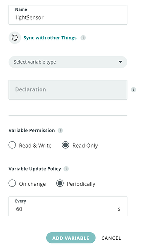

hello @in0, thanks for fast feedback.
I tried to add variable, but it also seems to be "blocked" (button is unavailable, and also "Declaration" field is gray - cannot add any text to this field)
Select device button works correctly, i can add device without any problem.

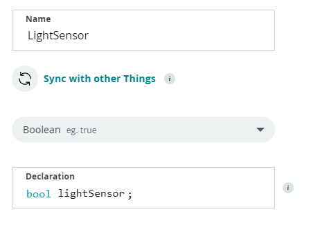

You need to pick a variable type from the "Select variable type" menu.
OK, I know right now what was was wrong. I do not pick "Boolean type" in "Basic types", right now everything seems to work correctly.
