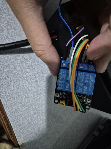

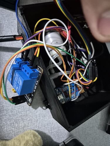

Please post a clear 'photo showing the D1 in place and how it is connected to the other components
is this ram okay shoud i remove anything, while i try to unbox my device?
Concentrate on getting MQTT running with nothing connected to the D1.
The example I posted works on mine so should work on yours
I'm sorry those 3 photos is as clear i can get too without destroying my friend stuff.

The project was obviously badly planned if it was not tested before committing to construction that cannot easily be taken apart.
You are now reaping the consequences
Suppose I said that the problem was with how some of the components, such as the transistors or the screen are connected then you would have to dismantle the project anyway
Bite the bullet, take it apart and test the example code on a bare D1 board. I know that works
