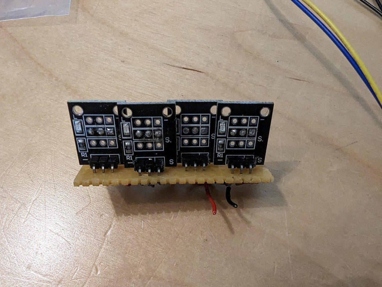

I'm currently having some trouble getting my hall effect sensors to work. Originally I bought these (KY-003/A3144 digital hall effect sensor and they were working fine until I decided to downsize my project a bit. Each of the hall effect sensors I bought came with their own little pcb, led and resistor. So they were pretty bulky. Eventually I decided to just cut the hall effect sensor from their pcb to use them on a single pcb.

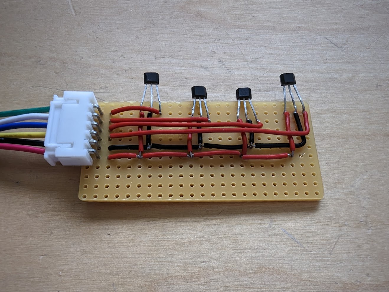

This is what it currently looks like
Cables on the left:
red: VCC
black: ground
yellow/blue/white/green: Pro Micro pin 10,16,14,15
I'm using the Joystick-library to turn these into contactless buttons for a HID controller. The problem now is, that they are not working properly anymore. I'm able to activate the sensors with a magnet, but putting the magnet close to the hall effect sensors also triggers a second sensor. Sometimes one of the sensors stays active the whole time, even after moving the magnet further away.
So, the question now is: What am I doing wrong here? The only thing that is now missing compared to the "bulkier" version is the led and the resistor. Removing the led shouldn't affect the sensor, so... is it the resistor? Do I have to add some pullup-resistors, even when using INPUT_PULLUP?

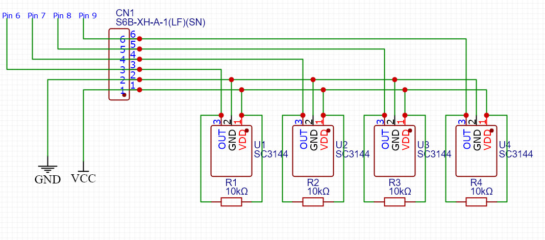

@gilshultz Here's the schematic

I've added the pullup-resistors as seen in the schematic. Once I plug in the usb cable, one of the sensors is immediately shown as active (=LOW). The longer I leave the pro micro connected, the more sensors are shown as active, even without any magnets nearby.

You forgot to annotate the schematic, no signal definitions or voltages. No clue what Pin ? is. No microprocessor shown. No power supplies shown.
After trying out a bunch of stuff I'm starting to think that there is something wrong with the wiring. I've replaced the sensors and the Pro Micro, but I'm still getting the same behaviour:
sensors switching high/low all by themself, no magnet used
This kind of behaviour only occurs with the board posted above though:
So I went back to my breadboard (as @johnerrington suggested) and it seems to be working just fine:
Breadboard works, prototype-pcb (whatever they're called) does not.
Checked for continuity too, but nothing wrong there either.
If that stripboard is something like our "veroboard" it has copper tracks on the bottom side that would short out all your connections!
