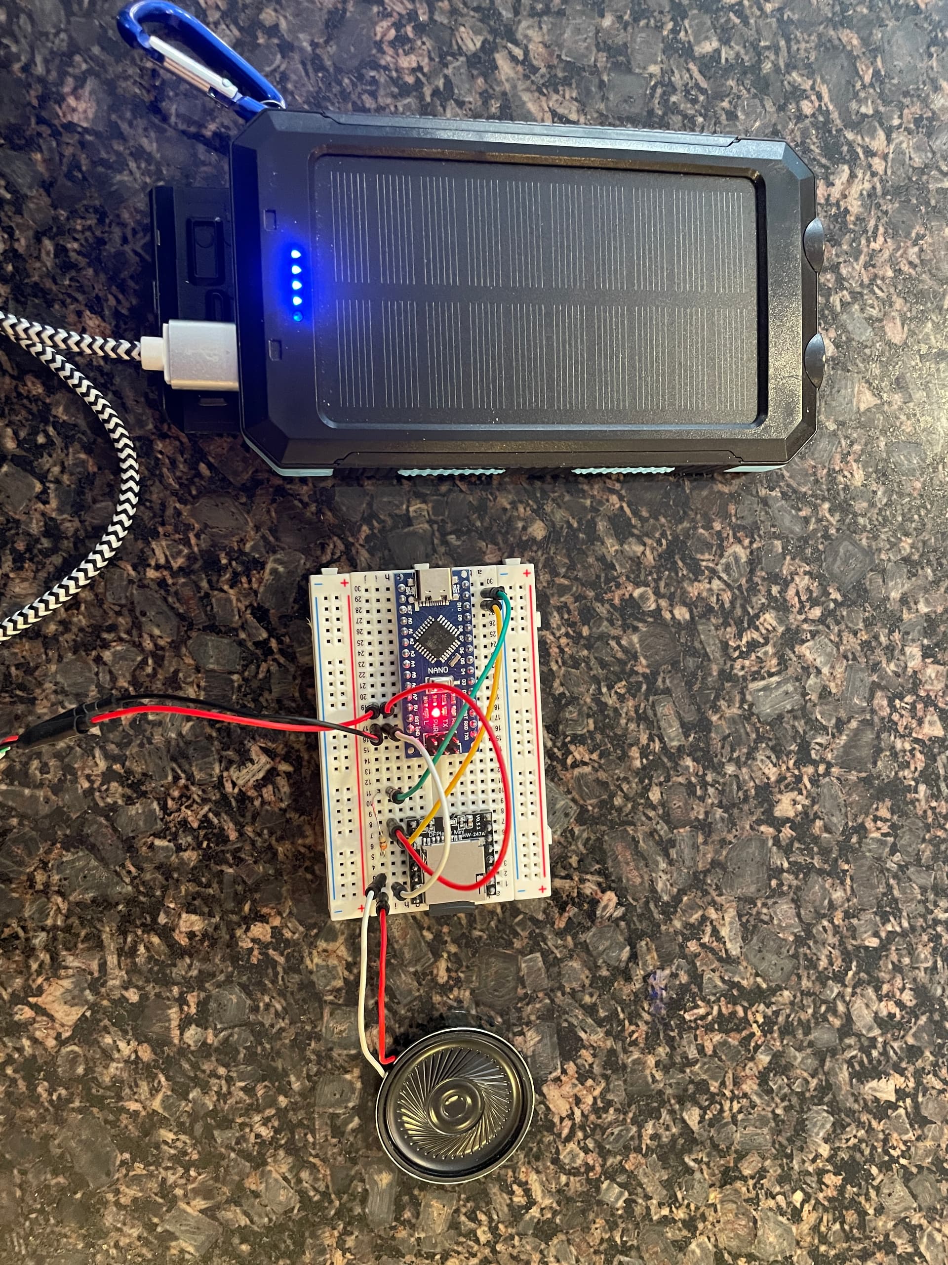

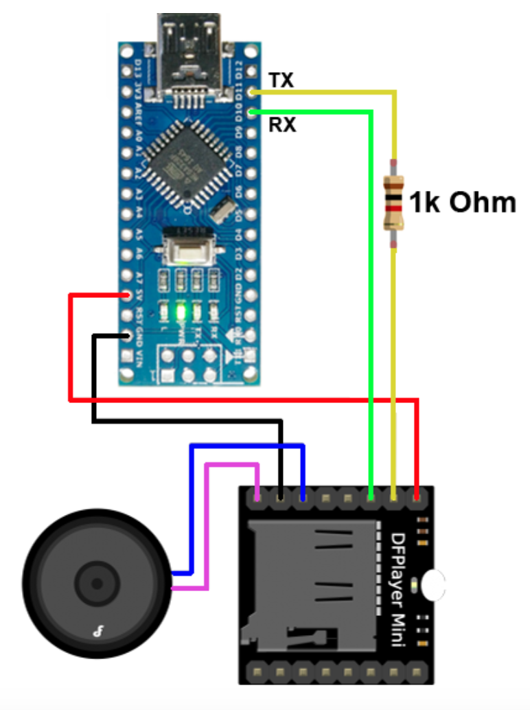

Here is the wiring diagram and a photo of the project. I tried switching the power source to the 5V input as you can see but nothing changed.

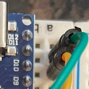

Are you sure that's 1K?
Code says one thing...
...pictures appears to show something else.
Eagle eyes fr :skull:
You have --
but the order is
(rxpin, txpin);
not negotiable.
No its 330 ohm. I didnt have a 1k ohm around but from what I was reading that should be OK. Is that wrong?
When I was trouble shooting one of the things ai came across said the pins are sometimes switched and suggested flipping them. It didnt work either way.
As van_der_decken pointed out - you are plugged into pins 11 and 10. Maybe look into that aspect of things, too. It's all about details.
Your resistor is too small, and you're using different pins than the sketch specifies. It's no wonder nothing works.

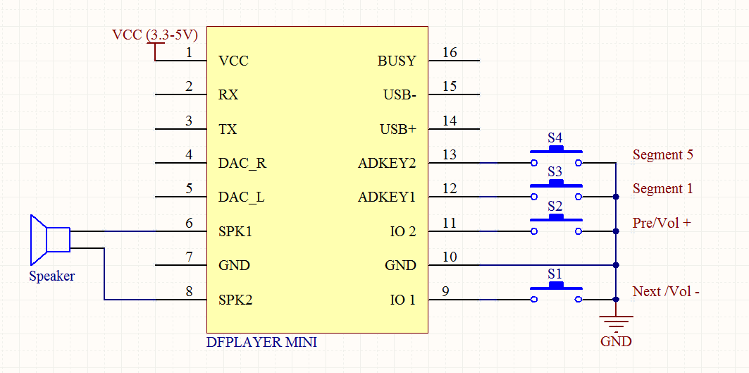

Have you tried triggering the player to play by connecting ADKEY1 pin to ground?
Where did you read that incorrect advice? If you still have no 1k do you have another couple of 330 ohm? If so use all three in series.

Those "solar" collector power banks do strange things. Some will not not supply power if the load is not sufficient (for example, needs to sense a "phone" sized device being recharged). Try a mains-powerd supply.
No I haven't. Im obviously new to this,. How do you do that? In other words what additional connections should there be? thanks
Addendum: I figured out how to do that and yes the audio played once I did it.
I agree. I tried several power blocks and this one was the only one that actually stays on. I also tried powering through the USB port from my computer. Both methods kept the Nano powered but neither produced any sound
I have since put three 330 Ohm resistors in series which should address that issue but nothing changed

Have you tried "I/O Mode?" No mcu required.

Yes thanks. I just got around to doing that a minute ago based on one of the suggestions above and that did ply the audio. Since all the connections are correct and the DFPlayer works in that set up you showed I am assuming the nano is the problem. Not sure what else it could be
