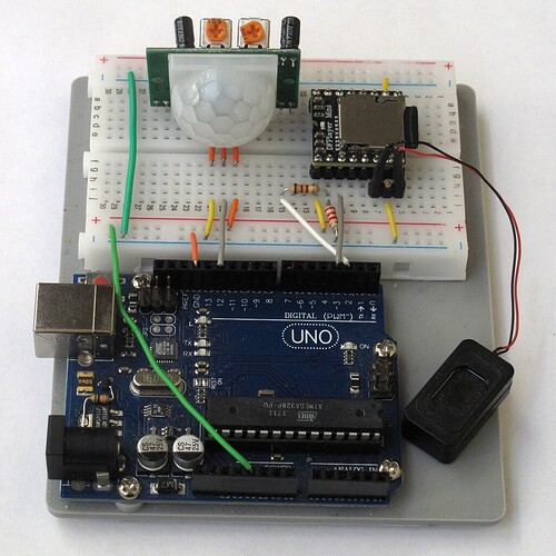

I have been following the tutorial at [https://racheldebarros.com/arduino-projects/trigger-sound-effects-with-arduino-pir-motion-sensor](https://racheldebarros.com/arduino-projects/trigger-sound-effects-with-arduino-pir-motion-sensor/)/ but I haven't been able to get it to work. I've rebuilt it again and again and inputted the code again and again but it still doesn't work. Any help would be appreciated.
 ![IMG_2145](https://europe1.discourse-cdn.com/arduino/original/4X/0/0/5/005b898da4965d55230ccfa8c6f638617f6f3952.jpeg)

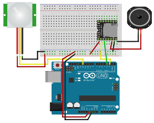

Both the code and diagram can be found on the website linked.
 ![IMG_2152](https://europe1.discourse-cdn.com/arduino/original/4X/1/9/2/1926672660b3a5b9282e14ebebc3e3a284d9a131.jpeg)
My code is based on the third example.

You have the Player's +V and GND reversed in your diagram.
The motion-IR gizmo is backward too.

> [@anon85221860](#):
> backward
If the breadboard is to be followed, the Uno +V/GND are backwards, causing everything else wired to the rails to be backwards.

What would be the correct placement and how could have I noticed it was reversed?

The red wires should go to 5V, the black wires should go to GND.
I can't correct fritzing - and that's why I abhor fritzing.

> [@izzopathic](#):
> still no sound.
First of all - your connections on the photo looks chaotic and very unstable. Using a wires with same color for different lines is not a good idea.
And next - do you see at least "Motion Detected" message in Serial Monitor? If not - it is too early to expect the sound, your motion sensor is not react.

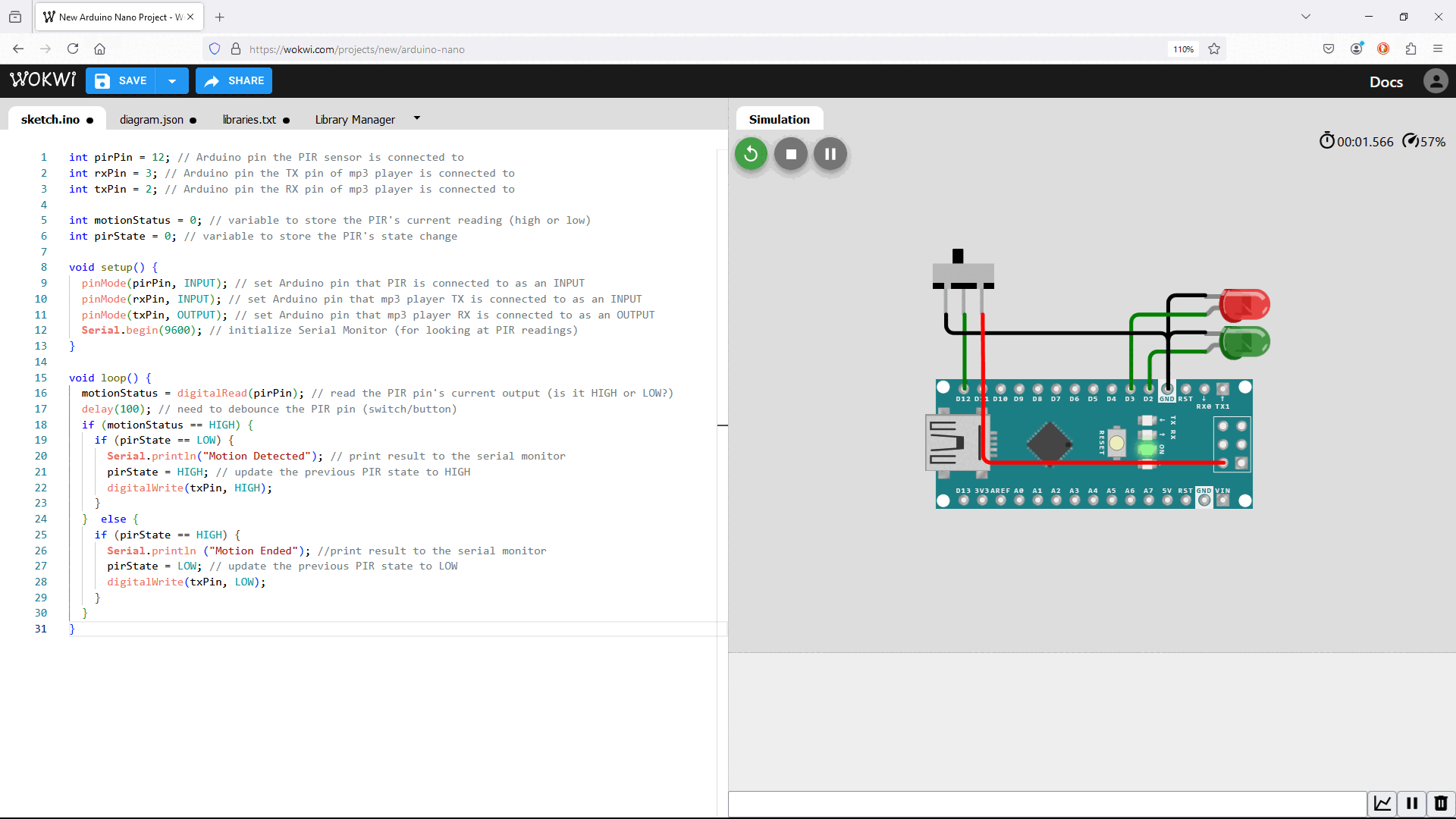

#diagram.json for wokwi
```arduino
  "version": 1,
  "author": "Anonymous maker",
  "editor": "wokwi",
  "parts": [
    { "type": "wokwi-arduino-nano", "id": "nano", "top": 4.8, "left": -0.5, "attrs": {} },
      "type": "wokwi-led",
      "id": "led1",
      "top": -39.6,
      "left": 141,
      "rotate": 90,
      "attrs": { "color": "green" }
      "id": "led2",
      "top": -58.8,
      "left": 141,
      "rotate": 90,
      "attrs": { "color": "red" }
    { "type": "wokwi-slide-switch", "id": "sw1", "top": -62.8, "left": 3.1, "attrs": {} }
  "connections": [
    ["nano:GND.2", "led1:C", "black", [ "v0"] ],
    ["nano:GND.2", "led2:C", "black", [ "v0"] ],
    ["nano:2", "led1:A", "green", [ "v0"] ],
    ["nano:3", "led2:A", "green", [ "v0"] ],
    ["nano:12", "sw1:2", "green", [ "v0"] ],
    ["nano:GND.2", "sw1:1", "black", [ "v-28.8", "h-115.2"] ],
    ["nano:5V.2", "sw1:3", "red", [ "h-124.8", "v-48", "h-0.2"] ]
  "dependencies": {}

I used your sketch (after replacing the colon with a semicolon) and wired things up accordingly. Unlike your setup, I reduced the 5V signal going to the DFplayer to its 3.3V allowable range with a 1.2K/2.2K voltage divider.
 ![PIR and DFplayer](https://europe1.discourse-cdn.com/arduino/original/4X/9/a/4/9a4eef3f83b7ffd12601e758bfc700429838fc40.jpeg)
Works like a charm. Move and a random track plays and "Motion Detected" is printed. Stop moving and after a while "Motion Ended" is printed. Rinse and repeat.
Assuming your wiring is now correct, I wouldn't be the least bit surprised if you've damaged either the PIR sensor or the DFplayer when you reversed the power going to them.
