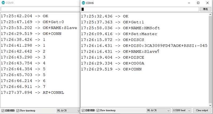

I use two UNO boards and two HM-10 Bluetooth so they can be interconnected, but when I power off and restart, they can't connect automatically. I also keyed "AT+CONNL", and it didn't return any message. :face_exhaling:
This is my serial port window:
