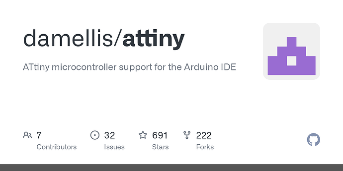

Do you have Attiny45 as selectable board? If not, you will have to create it. Btw, what is the speed of the internal clock, 1 or 8 mhz?
Here is a basic core package for attiny.
https://github.com/damellis/attiny
Install in sketchbook/hardware.
