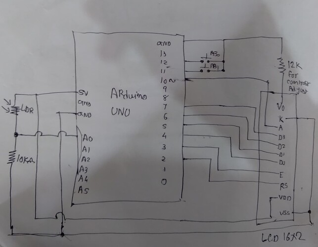

Hello I m using arduino Uno. One LCD of 16x2, 2 push buttons and LDR is connected to in. My test code increments number and prints on LCD when button is pressed. and every 5 second program reads LDR value using analogRead function. however what happens is first 5 seconds before LDR measurements, Button presses are detected as expected. but after exiting the section of code where i do AnalogRead, buttons presses are not detected anymore. can anyone point out why it happens?

Can you post a diagram / schematic of your setup?
Hard to confirm what the problem might be without that.

DB4-7 are supposed to be used on the LCD.
There is current limiting resistor on LCD Module so i think it should not cause any issue. However just to be sure, I disconnected the Backlight from arduino pin and ran code again but still same issue occurs. so it confirms issues is within code not connections.
I dont understand what you mean by DB4-7 can you please explain what it is? thanks.
On your schematic you show D0 D1 D2 D3 you are supposed to use D4 D5 D6 D7
Think that's a typo.. unless these are also named incorrectly..
d4 = 4, d5 = 5, d6 = 6, d7 = 7
oh yea its mistake in schematic. its actually connected to D4 D5 D6 D7

Show us a good image of your ‘actual’ wiring.

Okay finally found the issue. the problem was indeed with connections. I was connecting ground of Pushbuttons to AREF next to GND of UNO board all time. I should've checked connection more carefully lol. anyways, Thanks for all helpful responses.
