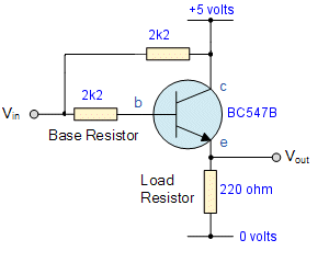

I am searching for a solution too for my Arduino Uno.
I know there's only one serial in/output on the Uno to use. But it is also used by the USB communication. There's a 1k resistor in the circuit that's keeping the signal low on the input. My Spektrum satellite is not strong enough to pull up the voltage high enough , so the input port won't notice any input.
I think we need a transistor to amplify the signal from the receiver to beat that 1k resistor.
Something like this:
But with lower resistor values, like 2.2k base resistor and 220 as load resistor

The transistor will invert the serial data. Try adding another transistor stage to invert the signal back to its original polarity.

This is the diagram I made to amplify without reversing the signal:
I'm sure it can be improved but it works for now.

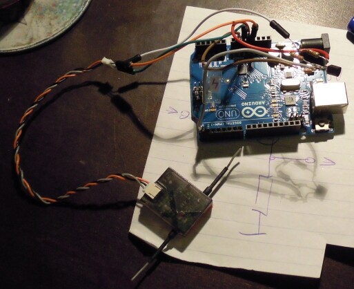

Test setup:
I had to do some code changes to get my channels right for my AR6210 DSMX satellite receiver. You can get my code here:
http://rc.andreotti.nl/aeroquad/SpektrumSatRx.zip
To upload the sketch you have to disconnect pin 0 from the amplifier so it does not mess up the RX. After that you can connect pin 0 to test it with the Serial Monitor.
One funny thing: I receive 7 channels with my DX9. I'm wondering if I could get all 9 channels to work.
