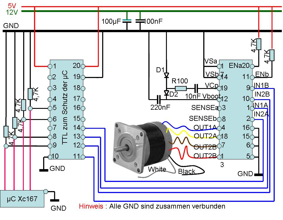

I have these bipolar stepper motors and I have been driving them with some easy drivers from sparkfun, but the problem is that easy drivers isn’t that cheap, so one of my friends gave me this drivers L6205N but I can’t get them to run this stepper motors, and I asked him how to use the driver and he said just use the Typical Application in the data sheet, and I tried the best I can but I can’t run the motor.
And then I asked another friend Google but the crazy thing that he can help me, I tried these examples at this site (I know they not are for arduino):
http://www.mikrocontroller.net/topic/152967
Now i give up and ask you guys for help, so are there someone out there know how to hook this L6205 up to a stepper motor and a arduion???

I also tried this just with an arduino instead of a TTL….
http://www.mikrocontroller.net/attachment/60471/Schaltung_der_Schrittmotor.png
also with no luck.
but right now I’m so lost that i don’t even have a setup anymore, any idea would be nice?
