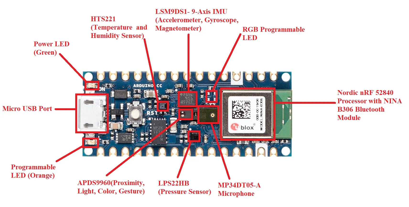

Take a look at this image so that we are talking about the same thing,
Your led activity is unusual, but since all leds are under software control, it indicates the the unit is alive. If the RGB and power leds are blinking it is because they have been programmed to do so. The Orange program mode indicator led is actually the LED_BUILTIN.
Standard power on configuration should just be the green power led solidly on. Only one port should show on the tools menu "PORT: COMXX (Arduino Nano 33 BLE") and the arrow leads to another repeat of that.
When you double tap the reset button the device should go into programming mode. The Green led should be solid and the Orange led should be pulsating slowly to indicate program mode.
Under tools, the PORT is blank and the arrow leads to a different port number which is the program port. You need to select that with Tools, and then it should show up after PORT: just like before, but with a different number. Then you can download a program.
From you description of the leds and the lack of a second port showing up, I don't think you are going into program mode with the double tap of the reset button.
However, your description of the led colors as to what is on and how after the double tap is confusing to me as there should only be a green and orange led and nothing blue.
I do not know the solution, but perhaps @in0 will have some suggestions.
