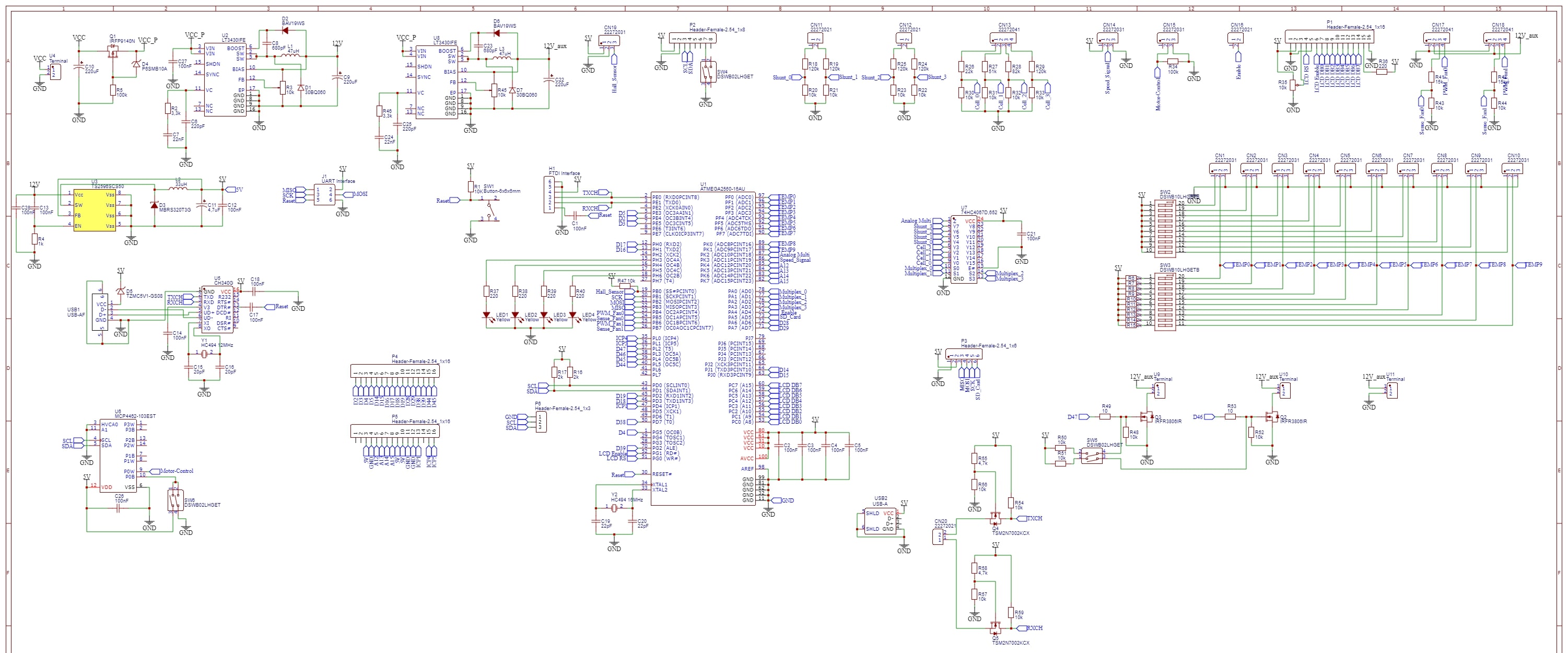

Hello,
as stated I have problems with uploading code to an atmega2560 chip. I successfully burned the bootloader using the icsp interface with an Arduino Uno, but when I try to upload any sketches with an FTDI or a ch340g, I get the following error codes:

Loopback test with FTDI was successful. Do you have any ideas on how to resolve this?
This is the schematic:
Your diagram does not indicate which FTDI/UART chip you are using. Some clones use FTDI drivers some clones use ch340. You have to determine which chip you are using and upload the same drivers for that FTDI/UART chip.
Good luck with your project
I‘m using an ft232-az breakout board as FTDI.
That's a busy schematic. Can you guide me to the pull up resistor on the RESET line?
The pull up resistor is on the top left side of the atmega.
This chip allows your computer, either MAC or WIndows to communicate to an Arduino. Did you install the proper drivers on your computer? Do you have a USB port on your custom board? If you have a FTDI chip on your Arduino then you can install the drivers for that chip.
Did you configure a boot loader for your custom Arduino?
You can also use another arduino or an Arduino programmer to program your custom arduino through the serial port.
My guess is that the auto-reset is not working. Does it upload if you press the reset button briefly while you are getting the "avrdude: stk500v2_ReceiveMessage(): timeout" messages?
Are you sure the bootloader upload was successful?
Did you try uploading a sketch (like Blink) with Sketch->Upload Using Programmer? (Note: That overwrites the bootloader so be sure to upload the bootloader again.)
I uploaded the Blink Sketch using an Arduino Uno as Programmer and it worked. I tested the serial connection with the FTDI and ch340g. With the FTDI I can only receive, with the ch340g I can send and receive but the characters I receive are weird:
When I send "a b c d e f g h i j k l m n o p q r s t u v w x y z" I get back "a b c d e f g h i j k l m n o ` a b c d e f0g h i j".

Do you have any ideas on why the ch340g gets the characters wrong?
Does your UNO have a removable processor? If so, you can try it as a USB interface by removing the processor and connecting these pins between the UNO board and the 'MEGA':
+5V, GND, Pin 0, Pin 1, Reset
See if that will let you upload through the MEGA bootloader.
We've only looked at a schematic. Maybe your PCB layout, PCB, parts, or parts placement is bad.
I found the solution. Apparently Ebay sent me the wrong ch340g chips, I desoldered the one on the PCB and I got it working with the FTDI.
Thanks for your help!
Great news, good luck with your project :grinning:
