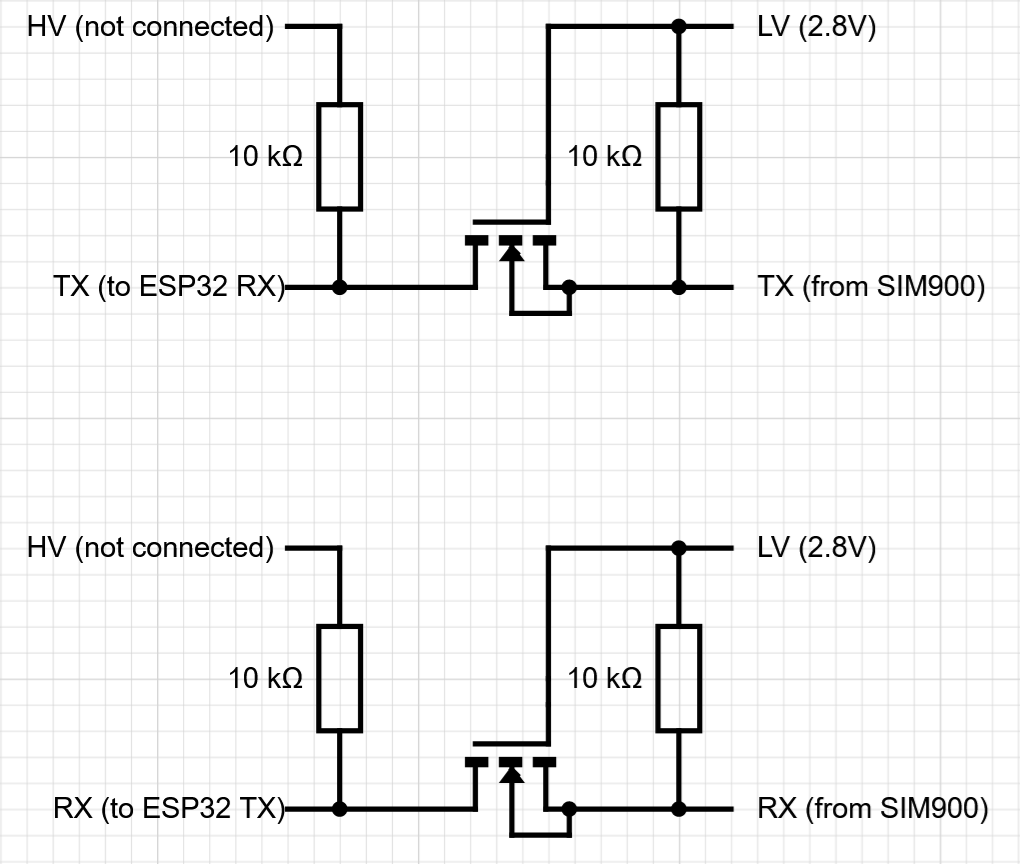

The I/O on the SIM900 is 2.80V, there is a built-in level shifter on this module but it's only for the TX and RX lines of the main UART port, I did not bridge the HV pull-up solder pad.
The serial communication between the ESP32 and the SIM900 works as expected, I can send AT commands and I get a reply from the modem.
There is solder pad that bridges the PWRKEY (PWK) pin to ground (top right corner in the first photo), I removed the solder bridge so that I can control the power state of the modem from the ESP32.
I used a 2-channel voltage level shifter to connect the PWRKEY pin and the DTR pin to the ESP32, same circuit as in the second photo, except this time I did not wire the pull-ups to neither LV nor HV.

I'm having a very hard time trying to understand how to enter and leave sleep mode.
When AT+CSCLK=0 and DTR is pulled-up, the PWRKEY pin behaves as explained in the SIM900 Hardware Design document, if the PWRKEY pin is pulled-down for at least ~520ms (document says 1 second) the modem powers on or off.
When AT+CSCLK=0 and DTR is pulled-down, the PWRKEY pin stops behaving as a toggle. The modem turns on and remains on while the PWRKEY pin is pulled-down, and turns off and remains off while the PWRKEY pin is pulled-up. If the PWRKEY pin is pulled-down for ~520ms the modem turns on and then immediately turns off.
When AT+CSCLK=1 and DTR is pulled-up, the serial port stops responding and I cannot type anything in it, and as soon as the DTR pin is pulled-down again the modem turns off.
When AT+CSCLK=1 and DTR is pulled-down, the serial communication works but the modem never goes into sleep mode. To enter sleep mode (AT+CSCLK=1) the DTR pin must be pulled-up, but that breaks the serial communication and when the DTR pin is pulled-down again the modem turns off.
