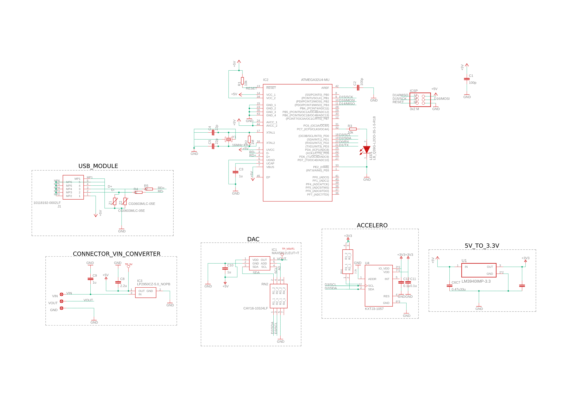

Here is my schema, I'm making a custom card based on an Arduino Leonardo, I wasn't able to test it on a breadboard...
There is others part in the board, ACCELERO, which is using I2C aswell, with an address of 0X0E. I've test it in another program and it seems to work.
In the DAC group, the CAY16-103J4LF is a group of resistor of 10K ohm, do you think it could be the source of my problem ?
I think the wiring is good because I can detect it with an I2C scanner and communicate with it. But maybe there is an obvious error I can't see, this is my first board ever :sweat_smile:
I'll check the github code.
Thanks for your help !
You wrote that you have a "Leonardo" board to make it simple for us, but we like to know everything. There are problems with the I2C bus on your board.
  • Where are the 100nF decoupling capacitors ?
  • You have 10k resistors in the signal path of SDA and SCL to the DAC. You are basically giving up on the I2C bus.
  • The capacitors "C8", "C9" and "C10" have the GND at the top and the 5V at the bottom. Please don't make a schematic like that.
  • The KXTJ3-1057 is a 3.3V sensor chip. That means it has a 3.3V I2C bus. The ATmega32U4 is running at 5V and it has therefor a 5V I2C bus. You connect those two I2C buses. The noise margin has gone and you are operating beyond the specifications in the datasheet.
  • The only pullup resistors on the I2C bus are the 10k near the KXTJ3-1057 to 3.3V. That is not okay for the ATmega32U4. It needs at least 3.5V at SDA and SCL to see it as a valid high level.
Thanks for your very interresting return and sorry for not having said everything.
  • I guess I forgot to put them but where do I have to put them ? There is only one missing after 5V of USB, right ?
  • I've understand that right after my post, so I unsold them and now every values are sent ! :grinning:
  • I'll change that
  • All right... So maybe the simpliest way is to change my sensor to have a 5V sensor ? Because I need a 5V output from DAC, I can't change that
  • The resistor near the KXTJ3-1057 are 2.2k but yes, I understand.

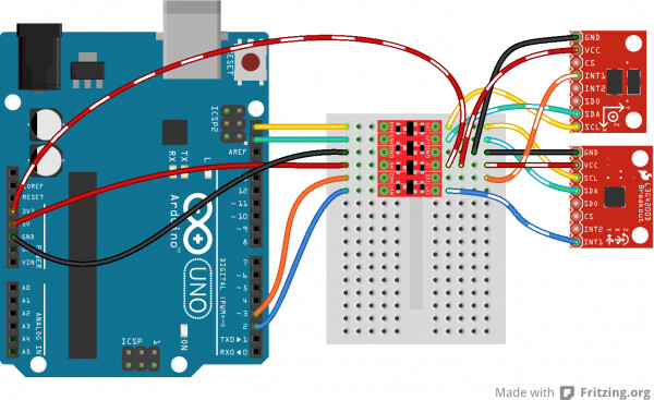

Or maybe I can use a level shifter to communicate with the accelero like this picture ?
Decoupling capacitors of 100nF should be everywhere. At the power and GND of every noisy chip.
Yes, a level shifter is a good solution. Adafruit often includes a level shifter on the module itself.
The level shifter has 10k pullup on every side, that could be enough pullup, or you may add a little more.
