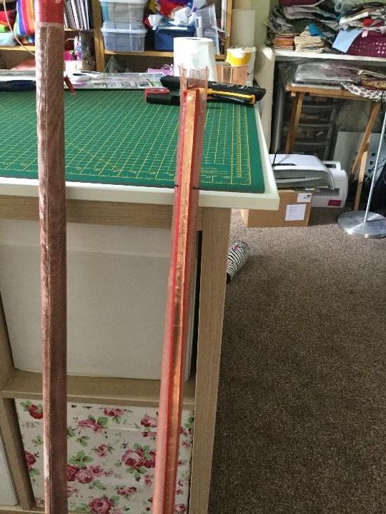

I’m trying to build a very long capacitive slider...two triangular contacts made of copper mesh. The readings between the two plates do not seem very reliable. I had hoped that a simple formula of
(Reading from plate one)/(sum of readings from both plates)
would be a reliable indicator of the position that contact was made...it doesn’t seem to be.
Does anyone have experience of getting the best out of this type of device? I’ve been quite successful at smoothing the output with a moving average array, but there’s still too much variation.
In the original thread above, TonyWilks used a separate pin to send a pulse which improved reliability but as yet I’ve been unable to replicate this...but I may well be (in fact, probably am) doing something wrong, plus I don’t know how to send the PWM signal to the pin that was grumpymike’s idea.
Mike, you may say “I told you so” at this point if you wish, but I ain’t giving up yet.
The real goal is quite simply a distance sensor, approx 800mm long, that reports back the position it has been touched...the more accurate the better, ideally to +/-10mm, but if unachievable, I could live with up to +/- 100mm...more than that and it won’t work for the intended purpose.
It also needs to be as unobtrusive as possible (invisible would be ideal, which is why the copper mesh was so tempting) and not use too many pins as it needs to run on a small format Arduino device.

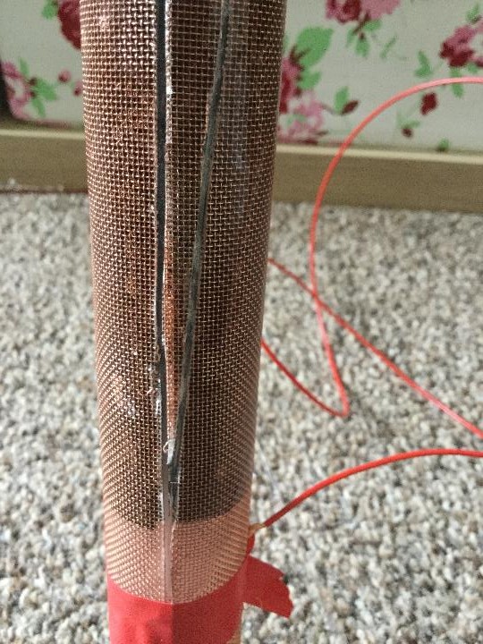

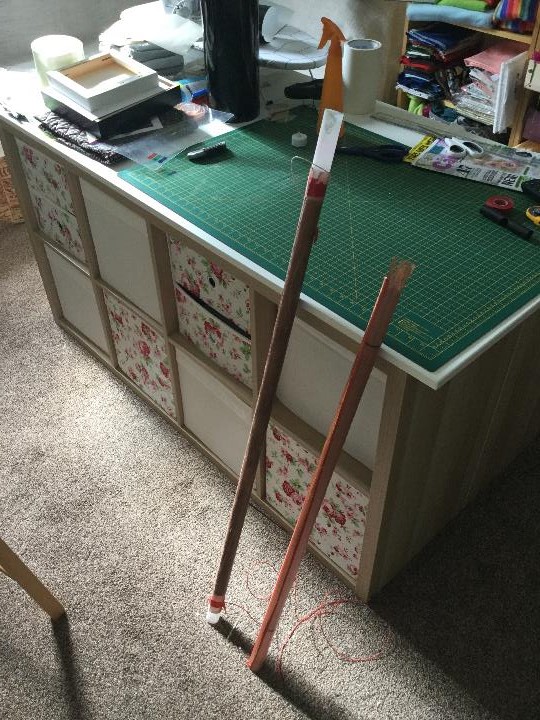

Pics of two poles, one with external driver strip (copper tape on red tape( I havent tried this on yet but I did introudce a copper stip into the other and got no real difference in output....
The copper mesh that makes the plates is set into rpoxy resin. THeres a slight difference in tube one is pole/vinyl/resin/copper whereas pole one is just tube/resin+copper,vinyl I plan a finaly coat opf resin, but don't wants to waste it if possibble.
Pics attached, if you need anythiing lese just yell..

GreyArea:
Pics of two poles... snip

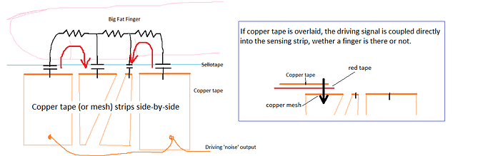

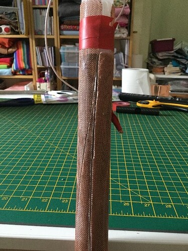

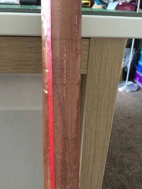

Picture1, Picture2... 2 poles, I see, one tape, the other mesh in resin.
Picture3 - that's some tape on top of red tape on the mesh pole. Probably not good - the tape will make a big capacitor and mess up the sensor I think.
Picture4 - detail of the mesh and the thin end of one of the strips - ok.
Picture5 - the other end of the mesh pole? - ok

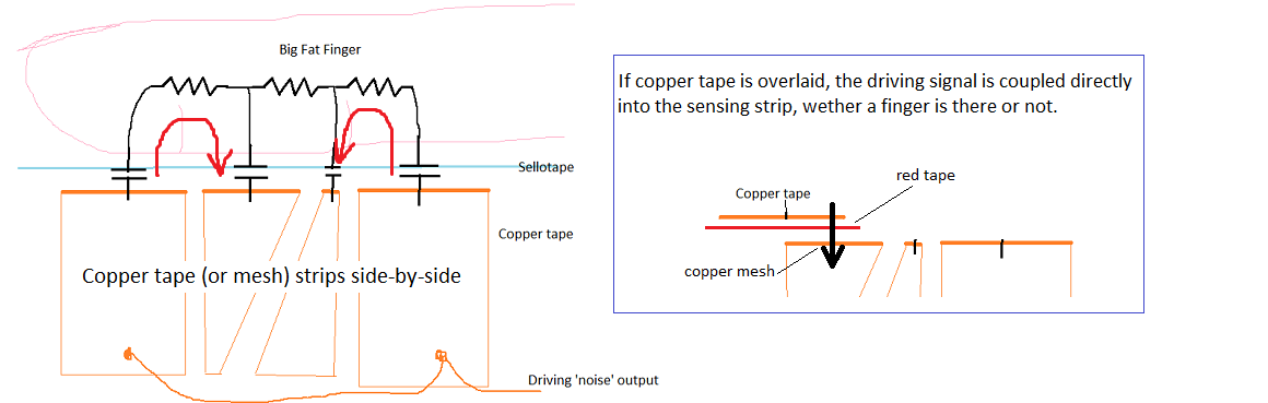

Picture6 - I'm not sure what that is showing. see my diagram again below
I'm still unfortunately using the same 1MOhm resistors rather than your suggested 10MOhms
They should be 1 MOhm, not 10 MOhms, see diagram: (it will not work without these resistors)

GreyArea:
As to the pics are you saying my layout is flawed, that the third “driver” strip won’t work if it is on top of insulation?
In Picture3.jpg it looks like you have the copper mesh cut diagonally and then there is some red tape with a strip of copper tape on top.
What it looks like is that the red tape and copper tape is on top of the copper mesh - which would not be good.

Yes, the first of those will hardly work at all. Look at the 'scope trace in my post above: the bottom 'driving signal' pulses LOW, when it rises it couples into the top 'sense strip' and pulls it up. Since the level is only held on the small capacitance of the strip, it decays to almost nothing in 6 divisions on the 'scope - that's only 120uS. The code only did one analogRead() in that time, if it then tried to analogRead() the other sense strip there will not be any signal left on it - so you have to drive before every read.

TonyWilk:
Yes, that's exactly how it is. Bugger. Does explain why it's not working!

... my contacts wrap around a pole, they meet at the back. I could arrange it so there's a single driving strip down the middle...
My prototype is sort of the opposite, the driving strip wraps around the pole and the sense strips are relatively thin.
The thing is your hand will pick up some 'driving signal' which needs to be coupled into both sense strips, you hand must cover the full width of both sense strips so that the ratio of the two signals is controlled by their width at that point - not by the amount your hand covers them by.
Since the calculated result relies on the relative strength of the two sense strip signals, it is not so important how much 'driving strip' your hand covers
e.g.
If your hand covers a point where Strip1 is 20mm wide and Strip2 is 5mm wide then Strip1 should get 4 times the signal of Strip2. The actual signal will be larger or smaller depending on how much 'driving strip' you hand is covering at the same time.
