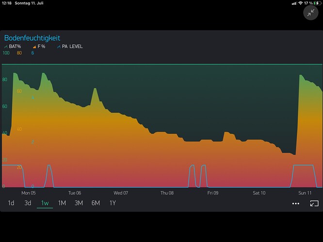

With all due respect sir: Electrode based sensors do corrode; capacitive sensors which the OP refers to do not (at least not quickly). Cover the electronics with two layers of clear nail polish and you'r good to go.
Image shows soil moisture over 2-week period (sent to iPad using Blynk). You can tell where it rained - smaller bumps - and where I watered - steep increases. Data is stable, sensor been running outside for months.
 ![IMG_0007](https://europe1.discourse-cdn.com/arduino/original/4X/6/2/9/629dcf92a4c168036e6b2d3c2764fc273843eba9.jpeg)
Fwiw: Sensor is battery driven and sleeps 3 hrs between reads. Use Pro Mini with RF transmitter to send data to base – low energy needs. Green line up top is battery level. Blue line is RF amplification level needed to reach base (Wemos D1). From base wifi-\>Blynk-\>iPad. Does what it should.

And how, exactly, did you verify that the readings mean anything useful, other than that the soil is drying up? No one needs a sensor to know that soil dries.

Sir: I have a roof terrace with plants. Sometimes it rains. Sometimes it doesnt. Sometimes I need to water. Sometimes I don‘t. Maybe nobody needs a soil moisture sensor. Mine tells me when my plants need watering. So I kinda like it for that.

I use this sensor [from Amazon](https://www.amazon.de/gp/product/B07R174TM1/ref=ppx_yo_dt_b_asin_title_o09_s00?ie=UTF8&psc=1). Give it 3.3 - 5V, read data line with analogRead and you should get changing values when you have it dry, moist, wet. If not then it might be defective.
I power it from a 3.3V Pro Mini digital pin. Set high only when needed to keep energy consumption low. analogRead gets sensor data straight from an analog pin. Average 3 readings for stability. Include two outlier catches. Map the value to a 0-100 percentage scale.
Here is the relevant code - nothing fancy:
```cpp
void FSread() // read soil moisture
  digitalWrite(3, HIGH); //turn on power to sensor
  delay(warmup); //give sensor time to stabilize (200ms)
  total = 0; //reset reading
  for (int thisReading = 0; thisReading < numReadings; thisReading++) { //take several (3) reads
    readings[thisReading] = analogRead(SensorPin);
    total += readings[thisReading]; //add them up
  digitalWrite(3, LOW); //turn off power to sensor
  average = total / numReadings; // calc reading average
  // Serial.print ("\nCurrent reading: ");
  // Serial.println (average);
  if (average < lowValue) { // catch outliers
    average = lowValue;
  else if (average > highValue) {
    average = highValue;
  //convert
  fs_sen_map = map (average, lowValue, highValue, 100, 0);
  // Serial.print(" Mapped fs average: ");
  // Serial.println(fs_sen_map);
Hope this helps.
