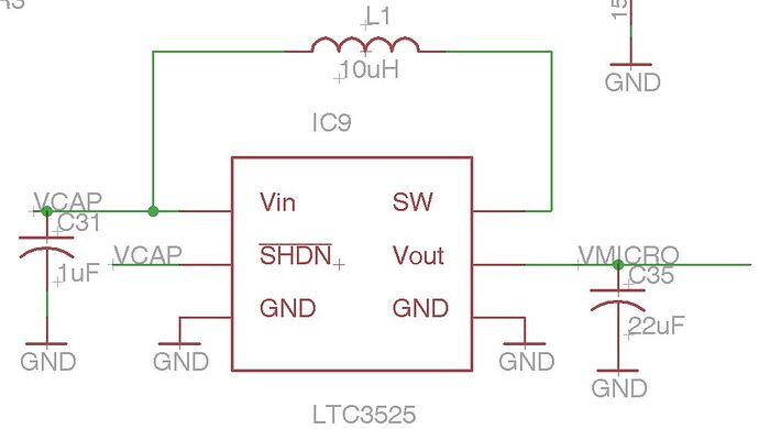

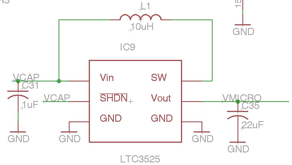

Might want to add a boost charger to hold the voltage up from whatever charge is in the cap:

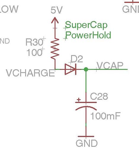

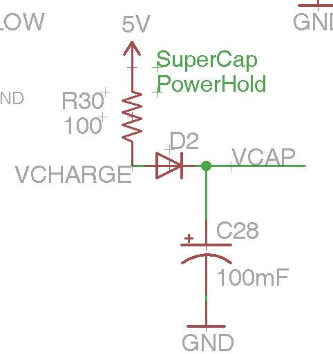

For example, I used these 3 circuits to power up a supercap, which was then boosted to keep a '1284P alive long enough to store data into an SD card.
I don't recall the math for how we determined the supercap size, it was 9 years ago.
