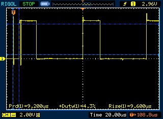

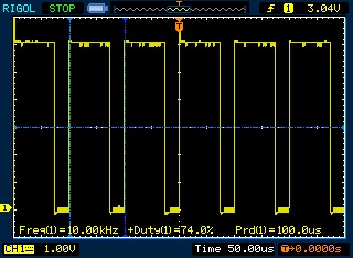

Paul, sorry for the delay; I was out of town and waited until I could get the captures from the oscilloscope.
Re using a DAC: I could have misunderstood something I read. I've been pondering this project for weeks and have read a lot about several topics, maybe I cross-channeled something. If "using a DAC" isn't viable/possible then it's me making a mistake.
In response to asking for the waveforms, here they are.
First, this capture shows the "running" pulses as the device heads towards setpoint.
 ![NewFile1](https://europe1.discourse-cdn.com/arduino/original/4X/2/8/f/28f1b82cf7afc1d2676058119e9d79a6d918cef3.jpeg)
I'm not especially good with any oscilloscope and I borrowed this one. This may all be garbage. This is one of two waveforms I tried to capture when the device was "dialing in" on the target.
 ![NewFile2](https://europe1.discourse-cdn.com/arduino/original/4X/3/3/8/338358cab85b4db638593d369dd7e8b1b378aff7.jpeg)
That didn't look quite right to me so I tried again and got this:
 ![NewFile3](https://europe1.discourse-cdn.com/arduino/original/4X/1/5/3/1535d33d43d9f91bebeb6a7fc8164f060cb94be5.jpeg)
This shows a 4.3% duty cycle. I'm not sure I caught the whole sequence. Yes, this is just a portion of the sequence, but I didn't see a clear flatline at the end to indicate the sequence was over while the feedback loop settled and was read/checked. I'm going to have to work on that some more but I'm not good with getting the oscilloscope to capture a sequence based on a trigger. When the device is near setpoint the oscilloscope goes from the steady trace shown in the first image to dancing around indicating an irregular pulse sequence. I tried to capture that by adjusting the trigger settings but...yeah, I've got "room for improvement".
--HC

Let me see if I have understood what's going on here.
The controller is aiming for some target position and the sensor tells it how far away from the target it is.
When the target is far away, the motor is run at high speed (74% duty cycle). As the target approaches, the controller reduces the duty cycle so that it does not risk overshooting the target due to momentum in the mechanism.
But below some low duty cycle, the motor stalls, and at this point the target has still not quite been reached.
So the controller then sends "nudge" pulses what are just long enough to cause a slight movement of the motor. After each pulse it waits for the sensor reading to settle and repeats as necessary until the target has been reached.
Does that sound right?

Paul, you have nailed it all except for the part where I reported information which I mis-identified. I'm an idiot and I made a couple of errors, see below.
As I stated in a post last night, I spent some time today further trying to identify/capture the "final" sequence waveform/pulses/nudges. I was able to fool the system into running as-normal while being torn apart: high-speed run-up slowing to the "nudges", all in one go. In doing so, I took out the motor assembly and found my first mistake: the motor, while tiny (3/8" in diameter or so, and maybe 1/2-5/8" long), is either a gear-reduction motor or feeds into a gear-reduction transmission. I had not caught that detail before. That affected the output of the device and that effect was misunderstood by me. That mis-identification is my second error.
The low duty cycle seen today was, indeed, in the 26% range over several tests. I probably bungled my use of the oscilloscope when I got the 4.3% or so seen in a screenshot. I borrowed the oscilloscope just for this project; I'm not good with it. I was unable to find an "end" to the PWM sequence because, apparently, there is no end other than the device terminating the drive when the setpoint is reached. The "nudges" I was seeing were, also apparently, _not_ electrical bumps but rather backlash/mechanical friction/transmission loading/unloading which evidenced themselves as short "nudges" of the final output. Doh!
Ugh, this seems to have been much ado about nothing. As I see/read the results now: the unit runs at "full speed" which is around 74% duty cycle PWM and which drops to "creep speed" of around 26% which is so low that the drive mechanism hiccups and bumps and "nudges".
The goal is to feed the output from the controller to an input on a uC and then lower the PWM duty cycle and feed that separately to the motor. The device is horrible about overshooting the setpoint and no amount of running the device's calibration routine will eliminate it. It runs at "full speed" until it's very close to the setpoint, exceeding the feedback sensor reading rate: by the time it thinks it's time to slow down, it's over the setpoint. A 70% failure rate is common. The manufacturer's answer was to send it back to them for a refund. I missed that window because I had a devastating fire in the Spring of 2024 and spent the rest of the year trying to recover and rebuild (lost stuff/building, not personal injury, thank God). I had more pressing life problems than messing with shoddy equipment. Now I'm stuck with it and I've (sort of) picked up some skills (few) with uCs...maybe I can hack it. As it is, it's useless; might as well try to improve it.
Thank you for your help. I'm embarrassed I didn't more-accurately understand what I was seeing.
