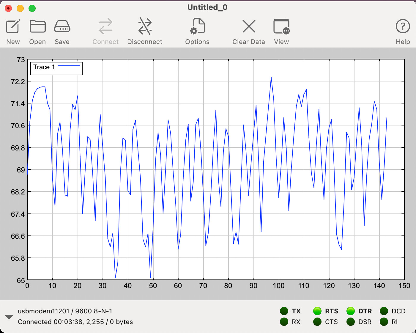

and here is the type of output I get when I read the output of a 40 Hz flickering white box on a 60 Hz monitor for 1 complete second, which looks to me still messy and not accurate actually!
So I have 2 main questions here:
1- is the photodiode code and filtering the signal correct and should give me a correct reading when exposed to a flickering signal at certain refresh rate, or must I use some specific libraries to do so (if yes, then which?)
2- do you have any suggestion for an accurate flickering stimulus that I can use as a baseline, for I suspect that the flickering process I am generating using Python/Psychopy library is not very accurate as I can see the flickering lingerring sometimes. Would an LED attached to Arduino and flickering at certain Hz (up to 100) do that or do I need another alternative?

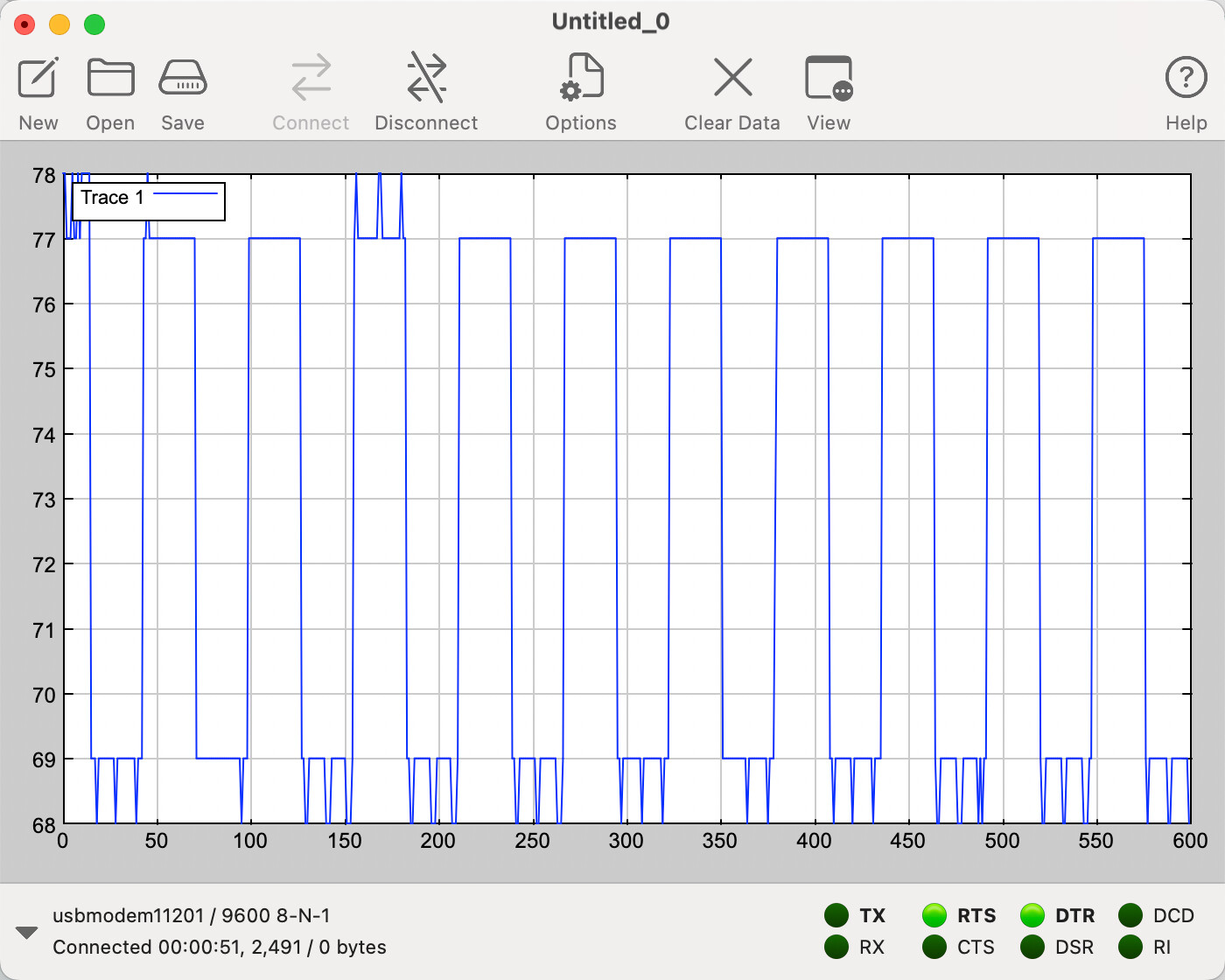

I was looking around and I found that I have a Raspberry Pi, so I made use of it and configured it so to use it for the blinker LED!
Now I have the LED driven by the Rasspberry Pi at a preconfigured frequency, for now 10 Hz (just to get things right first).
and here is the output of the sensor recording with no processing or anything, does it make sense to you?
PS: oh by the way I couldn't allocate an array of size 1000 on my Arduino, it runs out of space! so I allocated 600 for now --> hence I used a delay of 1666 msec instead so to fill 600 samples.
Ah yes, since I did not include the serial.println, my code compilied OK but you are right 1000 is too big
Don't change the sample rate.
Only change the array size to 600 and the i<1000 in the for loop to i<600
here is the kind of output right now. One can see 28 peaks for a 50 Hz signal.
I still do not understand how I am supposed to make it accurate to give an output of exactly 50 Hz (matching the LED frequency).
Could you please let me know?
