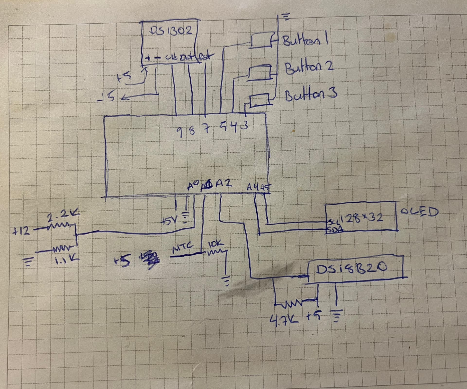

Car Mini Info Screen
Hi guys noob here;
A while ago I decided to get rid of my cars only electronic display showing clock (old 4-digit 7-segment) and make a new and updated one. I worked hard on it but I reached my limit with code being in that state. My info panel gets stuck constantly and the data I am trying to pull from various sensors seems to be not working. Please take a look and help me to be a better arduino user. Any help would be greatly appreciated, I am open for all types of suggestions.

Please post schematics.
You might be running out of memory. What board are you using?
This is the result from a Nano compile:
Sketch uses 22824 bytes (74%) of program storage space. Maximum is 30720 bytes.
Global variables use 681 bytes (33%) of dynamic memory, leaving 1367 bytes for local variables. Maximum is 2048 bytes.
I am using Uno variant and considering the OLED display on Adafruit library devouring almost 1 MB, there is still memory.
Sorry I really don't have one otherwise would have attached it.

You are in for an interesting ride in electronics. Post an annotated schematic of what you built and give technical details for each of the sensors. How do you plan on protecting the electronics you install? Here is some reading when you have a hard time sleeping but read it before going to far.
There is many good application notes such as AN2689 by ST on automotive electronics. reading it will help you a lot.
https://www.st.com/resource/en/application_note/cd00181783-protection-of-automotive-electronics-from-electrical-hazards-guidelines-for-design-and-component-selection-stmicroelectronics.pdf
Also take a look at these: Distilled Automotive Electronics Design | Analog Devices and
Transient Voltage Suppression in Automotive Applications
AEC-100 https://media.monolithicpower.com/mps_cms_document/w/e/Webinar_-_Fundamentals_of_AEC-
Understanding Automotive Electronics, An Engineering Perspective by William B. Ribbens
(PDF) .Understanding Automotive Electronics, Seventh Edition An Engineering Perspective by William Ribbens | Roman Perez - Academia.edu
Then make it! You didn't throw the components in a sack and just shake.
Pen and paper usually works fine.
Thank you all for your interest in the project. I sketched something very basic to depict the actual system. I don't have it with me now but I will add image of the actual box, cables and screen parts as soon as possible.
I missed something in the sketch. DS18B20 was attached to A2 pin before but I changed it to D2.
I will look into those sources thank you. In general I design circuits separate from the car wiring and I add a voltage regulator for my systems because car battery combined with alternator supplies "dirty electricity" fluctuating between 12 and 14.5 volts. I also use optocouplers wherever I need arduino to get data from car sensors directly.
You have not read the links I posted. I design for transients well over 100V. The older cars were much worse then today's. How about reverse battery or 24V double battery jump to name a few. I have seen transient results where 7805s were blown apart but the OEM modules kept on working.
You will probably be OK, you are designing for 1, I did it for millions where no failures were allowed. They meet or exceeded all of the links I supplied.
No I didn't read them just yet. I am trying to find my way with high school electrical knowledge :slight_smile: I currently use LM2596 to regulate and lower the voltage and always use on cable fuses because just in case. My car is 92 model I believe it is on the boundary of old and really old cars.
You are exactly right. You are a pro dealing with advanced design whereas I am a car enthusiast and it is just easier for me to replace a module rather than studying an entire curriculum :grinning:
