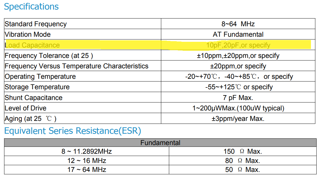

What can be the problem? Only thing I think of is the crystal. The PCB is a custom board, and attatching the crystal placed:
(LCSC) X322512MSB4SI YXC Crystal Oscillators | Crystals, Oscillators, Resonators - LCSC Electronics
(Datasheet) YXC Crystal Oscillators X322512MSB4SI Datasheet
Any thoughts on this? How can I test if the crystal is working or not?

C9 and C10 should be closer to 30pf

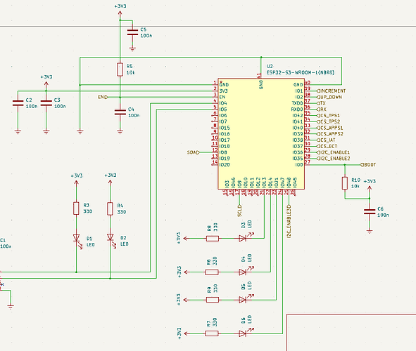

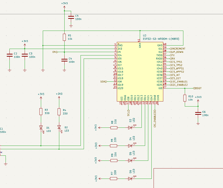

Here the full part of the schematics:
Uploading the only part where RX and TX interfear. I didn't post it since I thought that the RX and TX signals arrived fine in the other picture, since it is working with the FTDI.
As long as I know, the xtal is a 12 MHz crystal. Am I wrong?

I will try changing C8. Where do you get the 30pF for C9 and C10? I chose 20pF since it is what I understood from the datasheet:

The two capacitors are not equal to the the crystal load capacitance.
https://microchip.my.site.com/s/article/Calculating-crystal-load-capacitor
I use 5pf for the stray

DId not really get the formula you sent:
CL = (C1*C2)/(C1+C2) + 5pF
Assuming C1 = C2, does this mean CL is always 5pF?
Anyway, do you think that the capacitors can be the problem? I used to run some ATMEGA at 16MHz without capacitors on its crystal... Despite not being optimal, it did something. Here it does nothing.
Thank you!
If C1 = C2 then:
CL = (C2²/ (2C2) )+ 5
CL = (C2/2) + 5
CL-5 = C2/2
2
(CL-5) = C2
or
C2=C1=2*(CL-5)
However, you are right it isn't your problem.

I think C2 = 2(CL-5) would be correct.
Right. Thanks for catching that.
