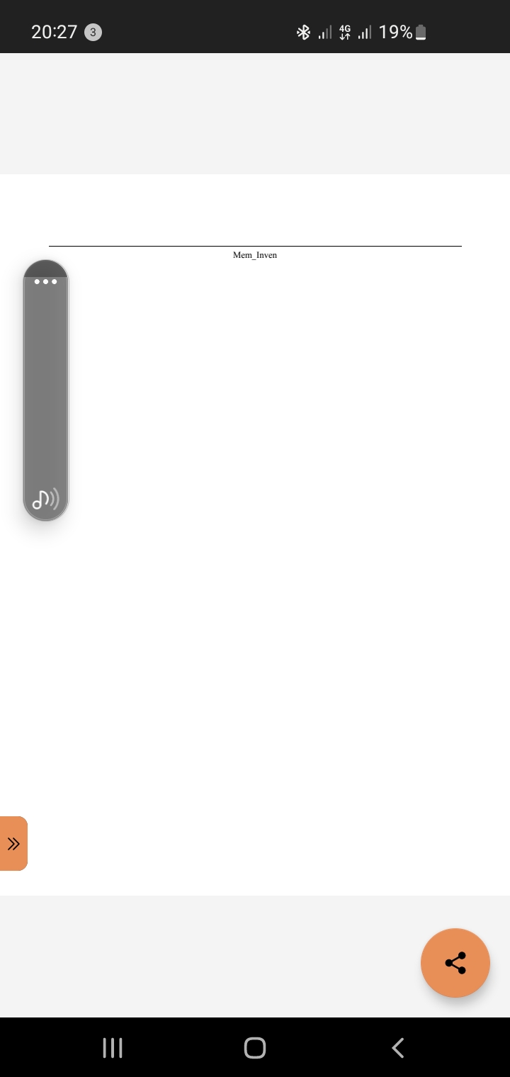

R2000 UHF RFID Reader Protocol.pdf (12.0 KB)
I see nothing in this document.
Sorry. I accidentally had "print selection only" turned on when I printed the .doc file to a .pdf so I could upload it. This version should be all 30 pages.
R2000 UHF RFID Reader Protocol.pdf (332.5 KB)
thanks. but this not same with my readers comm. protocol :pensive:
