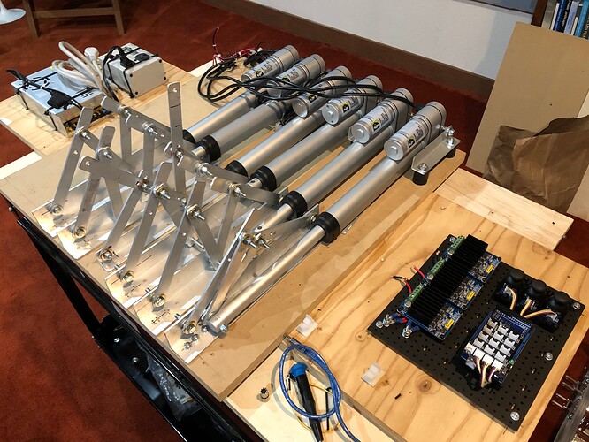

Been working with member Anshu_Raj on this for 6 months on a complex automated actuator movement. Happy to pay for help.
6-channel Continuum Robot like this: 3-segment Continuum Robot
13 feet, it sits vertically:
Components:
(6) Roboclaw 30A controllers
(6) CreativeWerks 8" actuators with position feedback
(1) Mega 2560
But right now we're just trying to get one of the six channels to work, and will duplicate the rest later.
Goal is to move one actuator:
  • To a random position.
  • At a random speed.
  • Circular easing applied.
Programming:
  • Movement is driven randomly from the Arduino.
  • It runs one loop with a random speed and distance, then it switches direction to do the same thing. Repeat.
Problems we have:
  • Glitches in analog position feedback.
  • Complex loop calculations.
How would you do it?
Latest sketch below.

To rephrase my question, How would you do write a loop that only takes an analog position read at the start and end?
