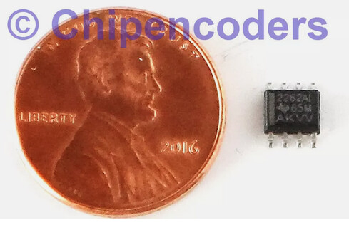

Will a surface mount devices (SMD) be OK.
If you are designing a PCB then SMD parts should be considered.
Size example
I'm really very new to this so I've only used a breadboard to date. My hope was to get the concept working on a breadboard and then the next step in the project would be how to make it into a neat and tidy board that is housed in a nice box of some sort. The size of that part you linked is attractive if I have to use 8 of them though.
OK so you will want a DIP package that you can plug into a breadboard. That limits the choices somewhat.
