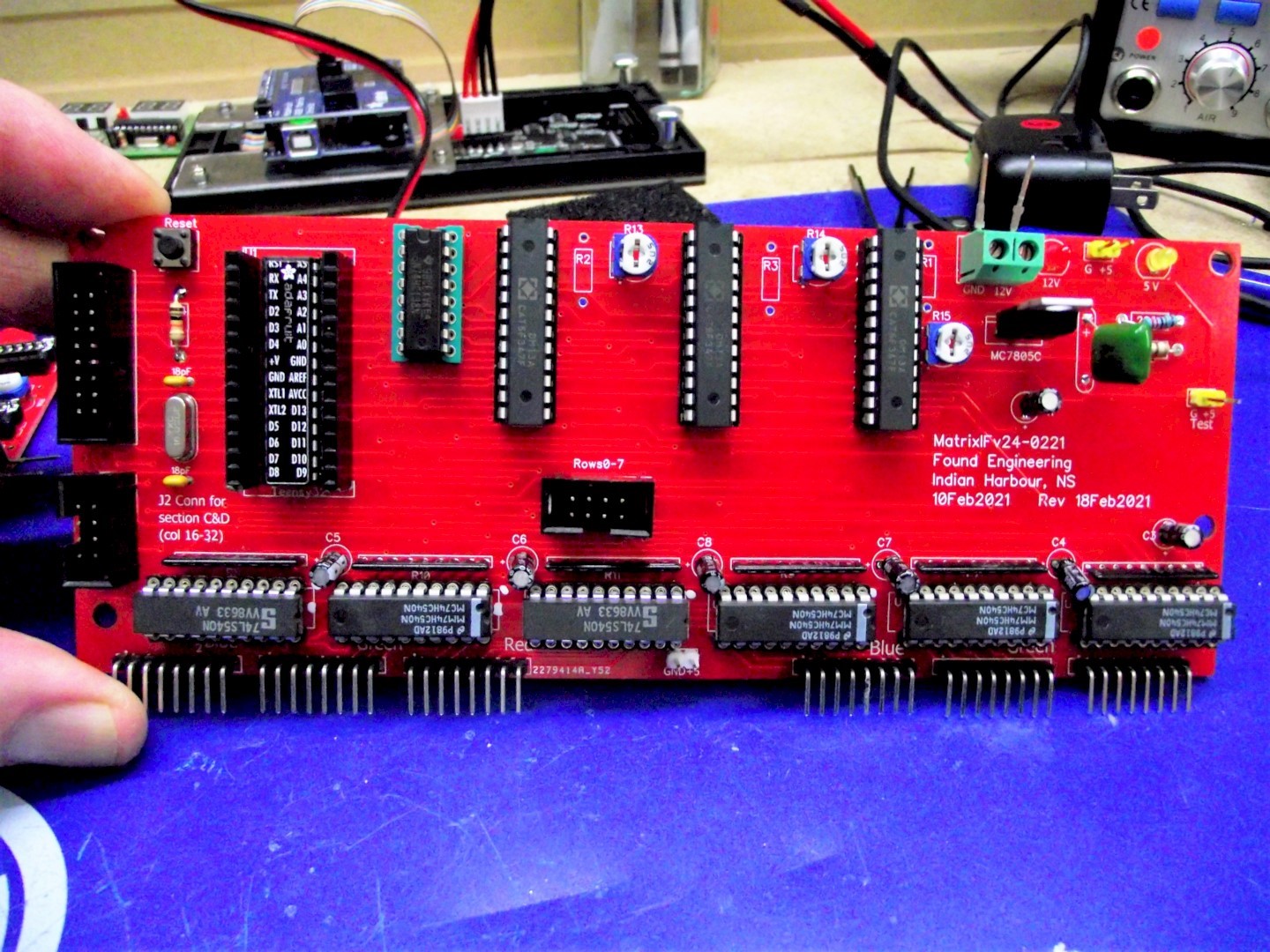

I made a large, high-intensity (1 watt) LED matrix display using hardware similar to Adafruit's 16x32 matrix display. (My 5 -oot-wide display is currently 8x32 pixels, with expansion coming). I did it this way, using the same HUB75 protocols so that I could use Adafruit's excellent library, RGBmatrixPanel, and their sample programs since I'm weak on programming with C++.
My display works but the (0,0)origin I chose was at top right of my display for ease in PCB layout. Adafruit's 16x32 display has origin at top left. Consequently, text is displayed in mirror image. (I looked at my display in mirror and it displays properly) See attached photo of my display. The ample program I used is Adafruit's "testshapes.ino" sketch where they write 16x32 in various colors to the display, on the top 8 rows.
So...my question, which I've posed to Adafruit, is "Can I change the library .cpp file to reflect a different origin or otherwise display my text properly?" Bouncing balls and smiley faces display properly of course since they don't care about starting points. It's only the text, static or scrolling that is affected.

I had a big long explanation in response to some of the replies above, and added photos and schematics, but when I posted, I got an error that "attachments were too large" and I lost everything. One of my photos hadn't been resized. Attached are schematics and one photo. The photo is of the logic board, two required for my display because they hold the DM13 and 74HC540s. First board has the Atmega and 74LS138 decoder, second board does not.
I've attached the Arduino sketch called scrolltextFE.ino which is my chopped-down version of Adafruit's demo program called "testshapes16x32".
MatrixLogic328.pdf (128 KB)
pixelboard.pdf (39.9 KB)
scrolltextFE.ino (1.42 KB)
In response to the replies:
  • Bill...what is setRotation function?
  • I don't know what a wrapper is.
  • The 74HC540's have inputs on left and outputs on right so it was logical to have the connections from the logic board (photo) to the pixel boards as shown. o/p zero is at top right of the chip, making the far right chip origin 0. It was a PCB design reason. I actually wanted (0,0) to be at the bottom left, like it is on a math x-y chart.

Having looked at the code, I don't think a simple wrapper will work, so I would go with WildBill /Deva_Rishi and try that method.
I tried the setRotation function. Looked promising but did not work.

SUCCESS!!
I changed all instances of RGBmatrixPanel to RGBmatrixPanelFE in the .cpp and .h files.
I tried rotation 0....no change
Rotation 2: Scrolling to the left, normal reading. IT WORKS!
Thanks one hell of a lot.
