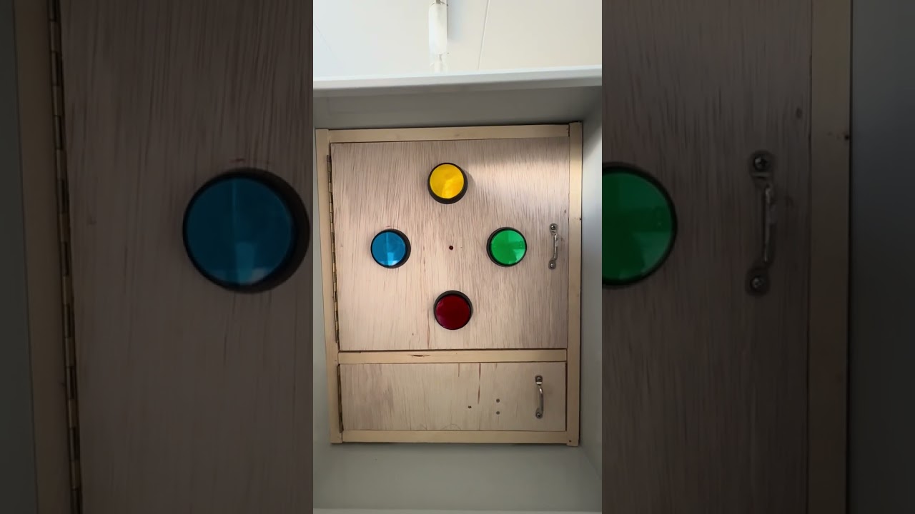

I have been building a Geocache that incorporates a Simon Says game that you need to overcome in order to open the compartment where the log is held in.
I downloaded the sketch I needed from a website that tells you how to build one of these caches.
His cache was made to work with a 9v battery that a cacher needs to bring.
However I decided to install an adapter that provides continues power to the Arduino/cache.
This presents me with a problem as the game will present the player with 4 tones and some flashing lights behind the buttons to initiate play.
Since my version of the cache is connected to continuous power the cache keeps playing those 4 sounds over and over.
This will drive me and the neighbours crazy since the cache is hanging on the side of my garage.
I could install a refridgerator light switch to provide the cache with power as soon as the player opens the case but I was wondering if the issue could be tackled in the code?
Perhaps someone has a nice solution as to how I could solve the issue of the flashing lights and the beeping of the speaker untill the player starts to play.
Maybe just remove that aspect of the game, but I am afraid I am not knowledgeable enough to know what exactly to remove.
Any help would be greatly appreciated - thank you very much for taking the time to read my question and possibly help me solve this issue.

I tried to put the code there but the lights still remain on after a win.
I made a Youtube video of it which can be watched here:
Post the code.
