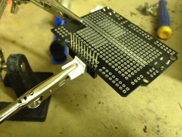

As to soldering on the headers on a shield....
I designed a little jig that, if you have access to a 3d Printer (if you don't, check 3dhubs for an available printer near you), will help hold female header pins perpendicular to the board.
Feel free to comment with suggestions.

That is so neat! I wonder if there is a part that can hold all 6 headers for a mega and sits flat on a bench :slight_smile:
So if I wanted to print this part, how much will it likely cost?
liudr:
Yes, it's called a block of wood with two saw cuts in it.
Yes.
Or a block of wood with other blocks glued on top in the pattern you need to align your headers.
For those with the design skills and the appropriate hardware available, printing things is sometime easier than making it. I'm going to design the device somewhere, either on paper, or in a CAD program, might as well use CAD, cause then I can just hit print and do something else.
As to cost, design something in sketchup or other cad program, and send it to shapeways or 3dhubs to see what it will cost. Usually one off items I charge $15-$30, which for what you want is really expensive, shapeways will probably be way more than that.

OK, great plan. Back to using my existing shields to prop up the headers.
Yes, that's what I actually do, but I thought it would sound too complicated.

I am using a 3 sec glue at the edges to hold the headers.......
