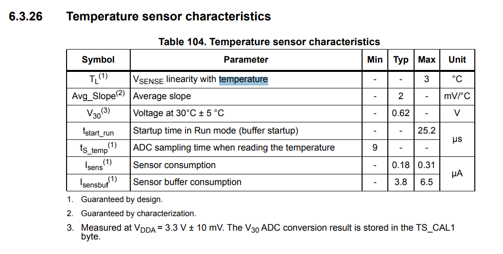

Is there any ways to check the CPU temperature for Portenta X8 without using an external sensor?

Do either of the processor data sheets mention a temperature sensor?

It actually does, just checked it

Which processor? How about the other one?

that was the STM32H747XI, and I don't think the ARM Cortex-A53 mentioned anything about a in-built temperature sensor.

I found it hard to believe that the A53 processor did not have a temperature sensor, so I checked. According to this overview data sheet, there is one: [https://www.nxp.com/docs/en/data-sheet/IMX8MMCEC.pdf](https://www.nxp.com/docs/en/data-sheet/IMX8MMCEC.pdf)
What Arduino LLC posts is the [Technical Reference Manual](https://docs.arduino.cc/resources/datasheets/cortexa53.pdf).

Thanks! I was looking at the data sheet provided on the Portenta Documentation page

Ye, knowing that it has a temperature sensor made it so much easier to read the chip temp with python. Thank you for your help

Do you guys have code for checking the temperature of the stm32h747xi?

```python
with open("/sys/class/thermal/thermal_zone0/temp", "r") as f:
        imx_temp = int(f.readline().strip())/1000
