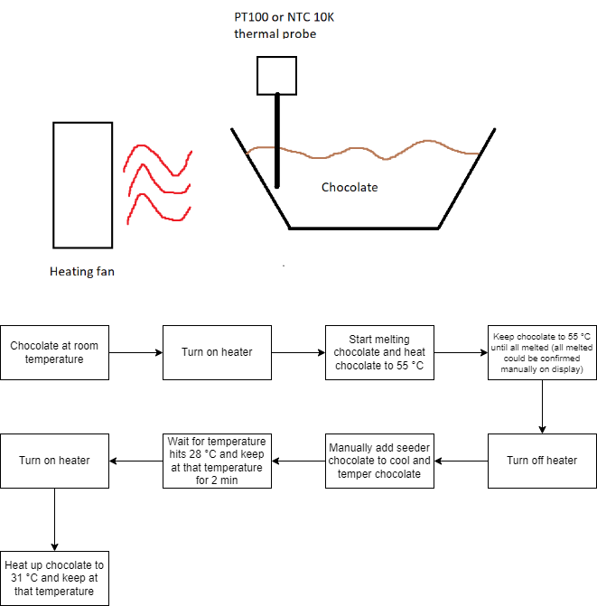

Make a system drawing (block diagram) to show what needs to happen. From that, devices and sensors that fit your purpose can be identified.
I tried to make a diagram of the process, unsure if that is what you meant (all temperatures will of cause have to be variable in my program, but it is always heat, cool, heat a tiny bit and keep at temperature). It is important in the process that the temperatures are hit pretty precise (fx. +/- 0.2 °C or something like that). To keep the temperature as precise as possible I thought power control of the heater would be nice, instead of simply turning on/off of the 1000 W heater, to avoid overshooting. Also it is not clear to me, how to change the continuous output of a PID algorithm to an on/off signal. Will clamp value of output between 0 and 1, and then round down below 0.5 and up above simply work? Will it be able to control temperature precise enough for a 1000 W heater, with the simple on/off?
There will also be stirring of the chocolate to keep the temperature even, but that is a simple on/off of a motor, and is not part of the control loop.

To do that requires the chocolate to be stirred and you snow NO stirring in the diagram.
since the fan out of the box can run with and without the heater I think I can run it independently of the heater. One of the reason I chose this heater fan. I know I will have to take the heater apart somewhat and rewire some of it, but I don't think that is an issue for me.
Agree, as I wrote under the diagram there will be stirring, but that will be controlled independently of the temperature, so that is a simple on/off control, which is easy.
