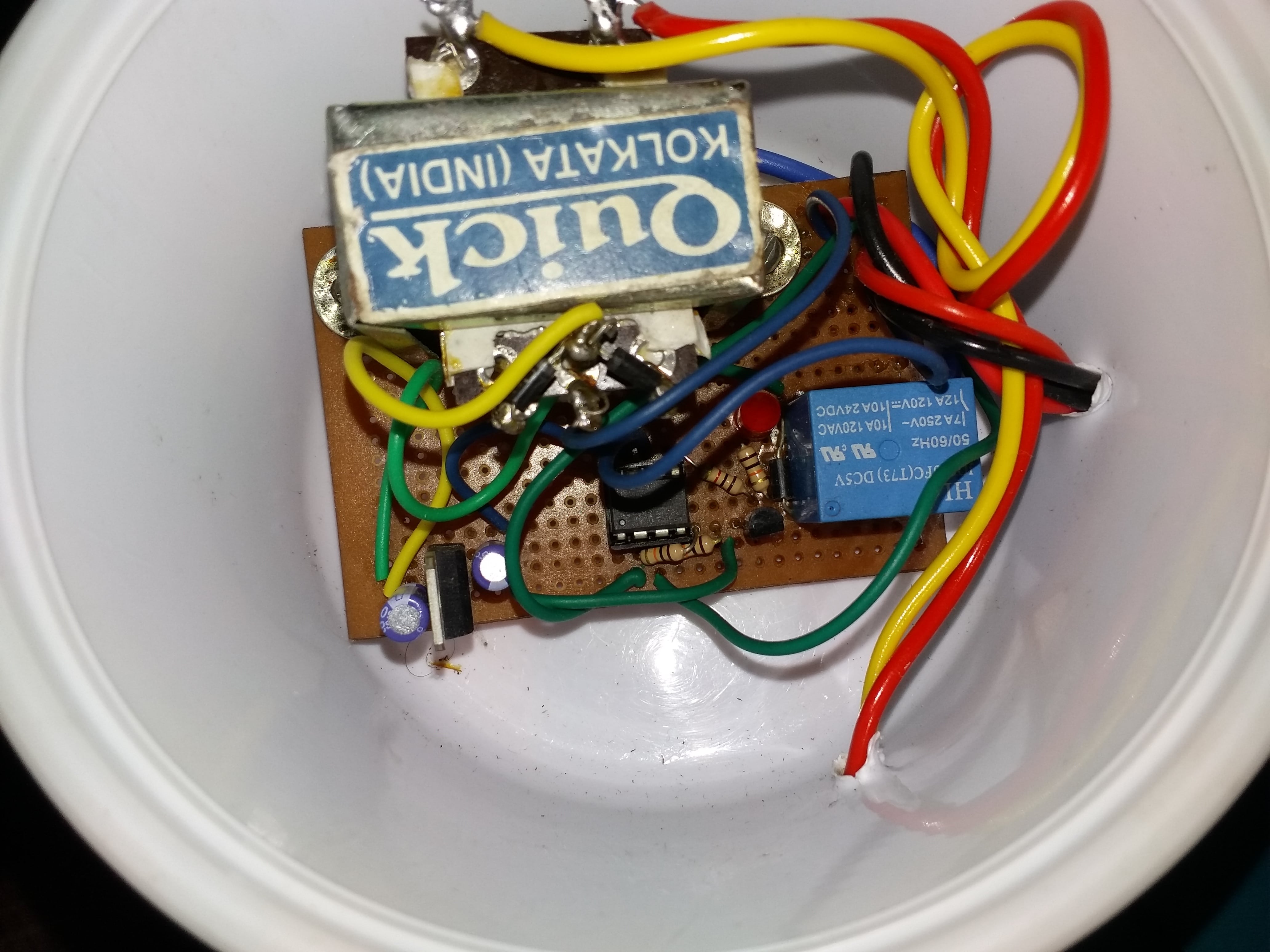

I have attached a picture. I don't have any schematic diagram but if you look at the picture, there is one Attiny13a, some resistors, one Led, transformer and a voltage regulator. The resistors beside the MCU are pull_down resistors and one for led and other for the 2n2222a transistor.
Although I made a fix by reversing the operation of relay, meaning when relay is powered the pump is not working and when relay is not powered the pump is working. But I still want to know why is it happening.

I don't see a buffer cap on the input of the regulator, just a (small/blue) 10 or 22uF decoupling cap.
That cap needs to be at least 470uF for that transformer based circuit (assuming ~100mA current draw).
Ripple on the 5olt supply could now be so high that the MCU just keeps restarting.
Add a 1000uF cap from regulator input to regulator ground.

What we need to see is a diagram, but you can start with posting the voltage you get on that buffer cap.
Must be about 9-12volt, assuming you're using an LM7805 regulator.
What voltage is that transformer. 2*6.3volt AC?
Leo..
Well, clearly you need a real reservoir capacitor on the input to the regulator. Presume it is a 7805, but that is not critical, I would suggest 1 mF, rated at twice the transformer (half) voltage.
Your wiring is not too bad, keeping wires reasonably well paired. I would still be a little concerned about something doing analog reads; we need the schematic to see just what you are doing.

It is a 9V 500 mA transformer.

I'm not guaranteeing it will solve your problem, but not having a smooth DC power supply will certainly cause problems.
An optocoupler would only be meaningful if you had two different power supplies to separately power the "Arduino" and the relay.
A SSR - Solid State Relay - would be a good alternative, correctly rated and using a heatsink which would not fit in your mug.
