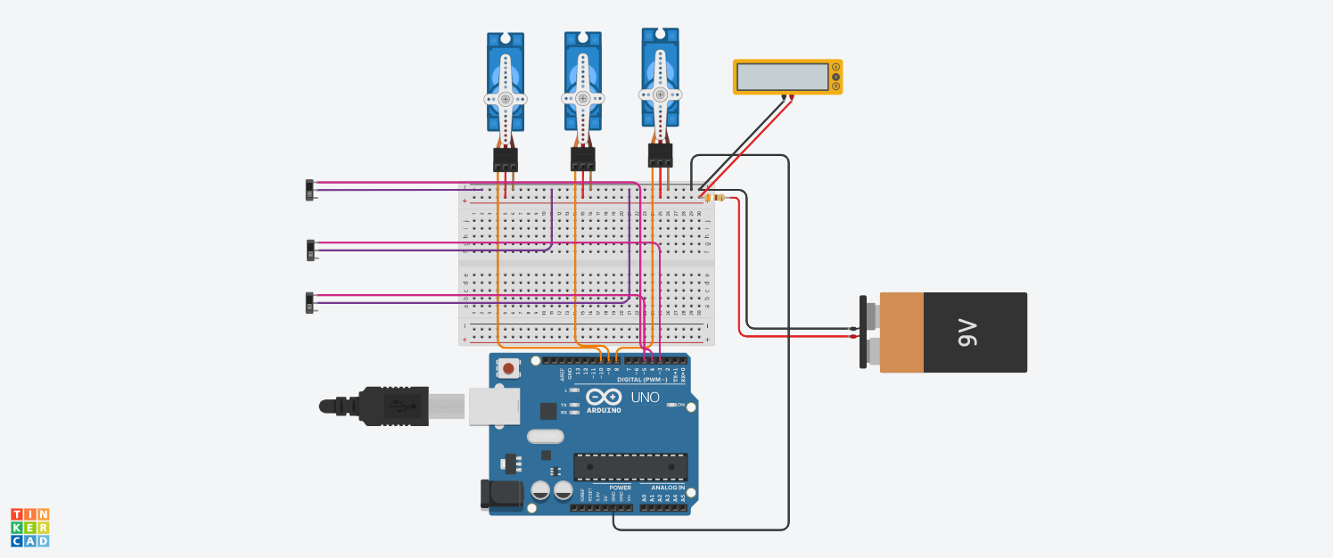

code here (made using blocks in tinker cad):
// C++ code
#include \<Servo.h\>
Servo servo\_9;
Servo servo\_10;
Servo servo\_8;
pinMode(5, INPUT);
servo\_9.attach(9, 500, 2500);
pinMode(3, INPUT);
servo\_10.attach(10, 500, 2500);
pinMode(4, INPUT);
servo\_8.attach(8, 500, 2500);
if (digitalRead(5) \< 1) {
delay(500); // Wait for 500 millisecond(s)
servo\_9.write(60);
servo\_9.write(0);
if (digitalRead(3) \< 1) {
servo\_10.write(60);
servo\_10.write(0);
if (digitalRead(4) \< 1) {
servo\_8.write(60);
servo\_8.write(0);
 ![Shiny Fyyran-Borwo](https://europe1.discourse-cdn.com/arduino/original/4X/2/d/d/2dd489417021042d5a75b0e1362e3f7f52ef9199.png)
this is my first try at code and using Arduino for a school project and I'm a bit stuck. I feel like I may be missing something but I don't know what, any help will be appreciate. Thanks

Looks like the power for the servos is being drawn through the board.
They will need their own power supply.
Leave the ground from the Uno to the breadboard, but remove the power.
You need an external power supply that provides at least a couple of amps at 5V.
You need to feed that power supply into the breadboard rail to power the servos, the ground wire you left connected is the signal ground.
Don't turn it on yet.
Next, your switches are backwards and will feed power from your new power supply into your board and that's no good. Even though they work in the sim it's not a good idea in meatspace.
Instead of connecting your switches to the hot, you can connect them to the ground and you can eliminate the resistors.
Instead of setting them to INPUT, you need to set the pin mode to INPUT\_PULLUP; that uses an internal resistor to make the pin read high unless you connect it to ground by activating the switch.
This means if the switch reads high then it is off, but if it reads low, then it is on.
```cpp
if (digitalRead(5) == LOW) {
    // switch is on
// or
if (digitalRead(5) == HIGH) {
    // switch is off
There may be more issues, but that's a start.

Please don't try to run servo power through a breadboard. They are only intended for low current. Servos and other motors are NOT low current devices.
Steve

 ![Sizzling Bigery-Vihelmo](https://europe1.discourse-cdn.com/arduino/original/4X/d/b/5/db5e081ab00bef986a16993ba0d7e7d4d52cc2e5.png)
<div class="post-metadata">
**Author:** ![er\_name\_not\_found](https://dub1.discourse-cdn.com/arduino/user_avatar/forum.arduino.cc/er_name_not_found/32/647693_2.png) [@er\_name\_not\_found](https://forum.arduino.cc/u/er_name_not_found)\
**Post date:** [November 9, 2021, 1:19pm UTC](https://forum.arduino.cc/t/circuit-and-code-works-in-simulation-but-not-doing-anything-when-done-it-real-life/921971/8 "2021-11-09T13:19:38Z")
</div>
What's the yellow thin in the upper right corner?
What's with the resistor on the power supply?
Which power supply do you have?
Please post a picture of your setup.

The yellow thing is just a multimeter I just forgot to remove. I put the resistor there so I only put 5v into the breadboard because I am using a 9v battery but I cannot get a picture right now.
**Post date:** [November 9, 2021, 11:03pm UTC](https://forum.arduino.cc/t/circuit-and-code-works-in-simulation-but-not-doing-anything-when-done-it-real-life/921971/10 "2021-11-09T23:03:18Z")
</div>
Resistors reduce current (amps) not voltage.
You may have some damage, but since it's a 9V battery you may be lucky. 9V batteries do not work very well for most any Arduino project and should not be used.
You need a 5V 2A power adapter as I described in [reply 2](https://forum.arduino.cc/t/circuit-and-code-works-in-simulation-but-not-doing-anything-when-done-it-real-life/921971/2).
Also, as @slipstick correctly pointed out my mistake, please connect the power for the servos directly to the supply, as the breadboard should not have that much power through it. You should use a switch here too and that switch should be able to handle 2A as well.
It is not advisable that you proceed without the correct parts. Please feel free to post links to those parts here for review, before you order them.
Also I need a photograph of your breadboard and setup please, not just the drawing.
