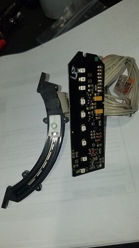

Hi, Im working on another project.
I have an OEM gear shift circuit that has a sliding contact which connects ground to the corresponding gear position and in the original circuit, it lights up the led.
I need to tap into the Reverse Ground signal, and the output signal can only be ground. The issue is, when its not in reverse, I measure anywhere from 4v to 7.5v on the Reverse signal wire as I change gears - Reverse to Neutral to Drive
Maybe some type of diode if so which one?
Clint
 ![20240213_173801](https://europe1.discourse-cdn.com/arduino/original/4X/7/3/d/73d94989a015e9efee848d61793b1620f49dfa60.jpeg)
 ![17079425787794684975885248775414](https://europe1.discourse-cdn.com/arduino/original/4X/f/0/c/f0c9644d283d82351a72f30609a05d6847516e06.jpeg)

The pictures is the factory gear shifter position circuit that lights up the factory LED board... all OE factory (besides me cutting the reverse signal wire for testing)
I just want to tap into the reverse LED ground signal to send only ground when in reverse to the instrument cluster.
But when testing (wire striped back and just checking with volt meter, - one lead on chassis ground and other on the reverse LED signal when moving shifter to other gears, it had 7 some odd volts when not in reverse.
Ill get a video tomorrow illustrating this.. I think the Factory circuit is just back feeding? and has no effect on anything else since in the factory/original circuit it would only be connected if it were in Reverse.
@johnerrington , conect to the instrument cluster, it is expecting ground or open circuit on the input pin. I don't know what would happen if it got voltage, I just rather not "just send it" as it would be expensive to replace.
I'll try and update tomorrow evening with the video... Worst case - I just leave the reverse signal open, not connected to the Factory circuit board (led will not light up) and just use that ground signal for the Instrument Cluster.. kinda want to avoid this but its an option.
clint

The safest way to tap into an existing board is with an opto coupler.
Connect the opto LED (with current limiting resistor) across the indicator LED or across the voltage that powers the indicator LED+resistor. You only need 1mA or so for the ~1.2volt opto LED.
Connect the opto transistor between an Arduino digital pin and ground, with pull up enabled.
Leo..

this Isnt for a simulator, its for my engine swap that I've done 9+ years ago and finally want reverse lights to work.
@Wawa thank you for the octocoupler idea.
I had several 4n35 from a previous project. I had an old USB cord for testing with 5v power supply power bank. When testing, it had about 170Ωwhen connecting ohmmeter ground to pin 5 of the chip. I wasn't sure that would be good enough so decided to try it since its only ground signal. Not sure if a different octocupler would have a lower ohm value + this is in a cheap cheap breadboard that might be contributing to it.
5v power supply + 370Ω to pin 1
ground to pin 2
instrument cluster (waiting for ground ) pin 5
ground to pin 4
when pin 4 is connected to ground, It worked when using a 5v cigarette lighter (so it shares chassis ground)
now to find a resistor value for 12v to power the octocoupler and test again
thanks for everyone's help and ideas
