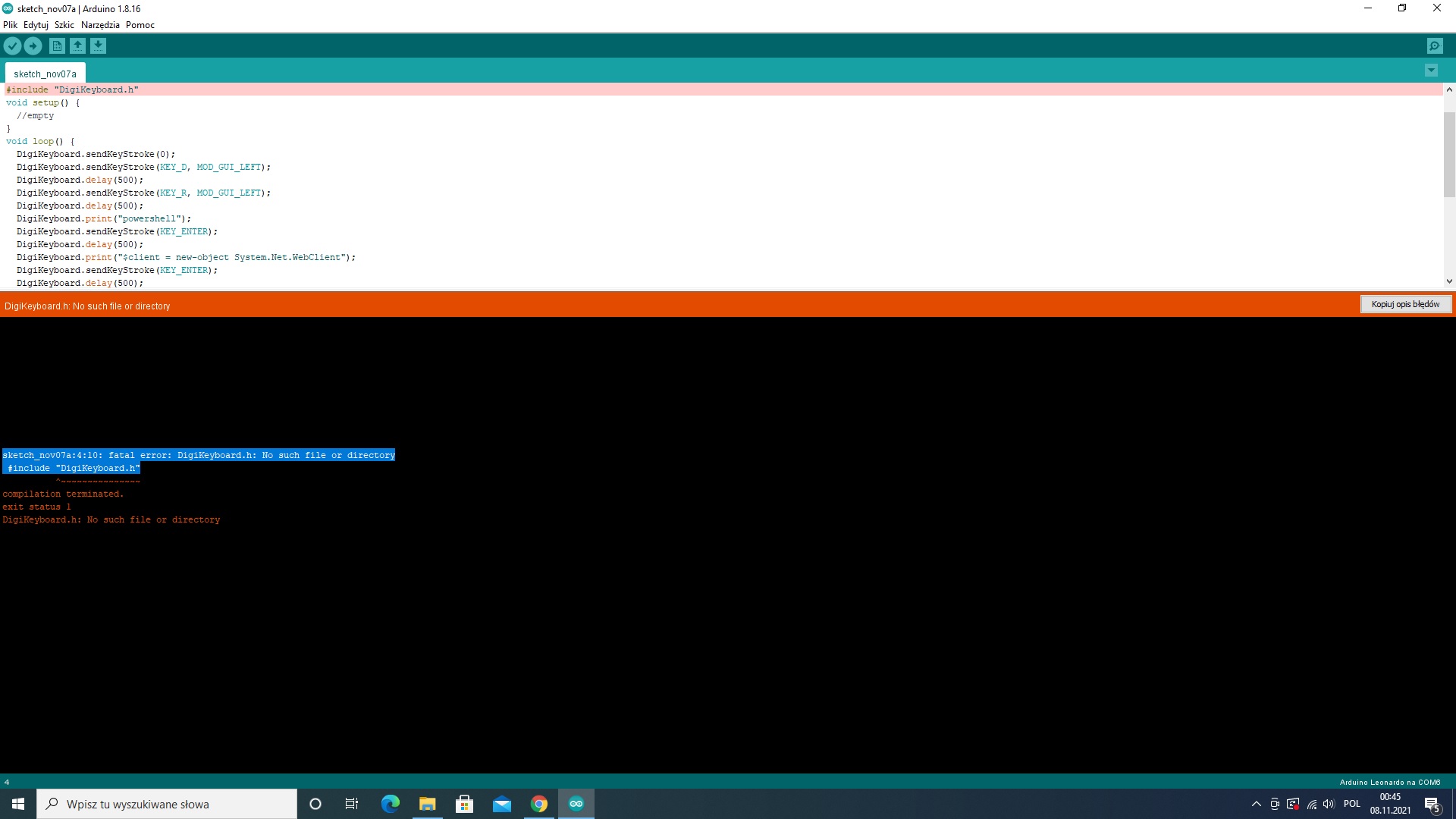

now i try in Windows and stable 1.8.16 version and ...
when i try blink everythink is ok
but when i try script with #include "DigiKeyboard.h"
Please tell me how this "Keyboard.h" file ended up in /home/anonim/.arduino15/packages/arduino/hardware/avr/1.8.3/cores/arduino/
The "DigiKeyboard" library is written for the ATTiny85-based DigiSpark board. It is bundled with the boards platform for the DigiSpark board. You can't use it with your ATmega32U4-based board. For your board, you should use the standard Keyboard library:
https://www.arduino.cc/reference/en/language/functions/usb/keyboard/
Ok so please tell me what i must do now :slight_smile:

ok when i put good script for example icnlude not DigiKeyboard.h , but Keyboard.h and then i see this problem
/tmp/.arduinoIDE-unsaved2021108-364670-f4tqs1.5r9e6/sketch_nov8a/sketch_nov8a.ino: In function 'void setup()':
/tmp/.arduinoIDE-unsaved2021108-364670-f4tqs1.5r9e6/sketch_nov8a/sketch_nov8a.ino:37:26: error: wrong type argument to unary minus
 type(KEY_LEFT_SHIFT,false);
Compilation error: Error: 13 INTERNAL: exit status 1
It is not necessary to make a new OS. I am still curious about how that Keyboard.h file ended up in your core, but I guess I'll give up on solving that mystery. So let's move on.
First of all, I want to make something very clear to you because I don't think I got through yet:
YOU CAN NOT USE THE DIGIKEYBOARD LIBRARY!!!!
Enough said about that. Now for the solution:
Your installation of the "Arduino AVR Boards" platform of the Leonardo has somehow been corrupted. The solution is to remove the bad installation. Please follow these instructions:
