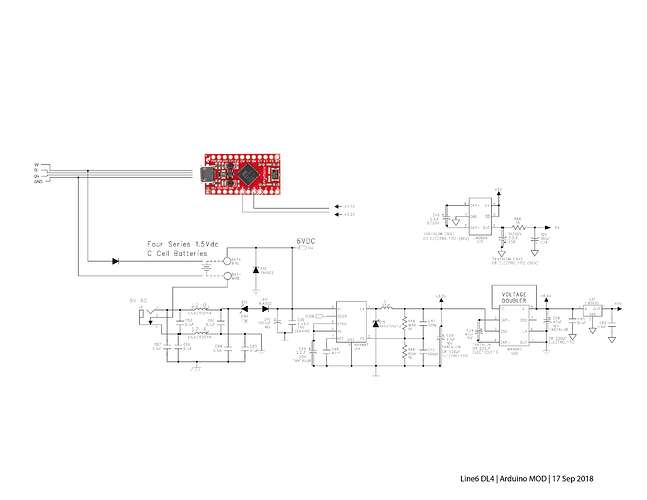

cleaning up 5v usb power
modified a guitar looper in order for it to take a USB cable that would
1
take midi controls via pro micro arduino
(achieved that through vital support on this forum. thanks paul!)
2
power the looper via 5V coming from the usb port
unfortunately though, the 5v usb power introduced a lot of hiss to the audio signal. don't know how to approach this, but tried this today:
cut an usb cable and spliced in 5v from a battery, while arduino data still came from the usb port. this turned out to remove 80-90 % of the noise.
so, if in principle i just have to cleanup the 5v from the usb, how would i go about this? is there a ready made solution (like a small boost converter)? can i follow a schematic and build something from scratch?

You have a problem here with ground layout. You can use an inductor and capacitors to filter the 5 V, but the ground connections must be laid out in a certain manner.
Paul__B:
hey paul
thanks! could you pls give me a few keywords/principles for the ground layout. is there a set of rules for (audio) ground connections?
It basically means making sure no section of the ground wiring is carrying both your audio signal and current to a digital device.
I would suggest making a diagram of how you propose to connect things, and we can criticise that.

finally understood what was meant by ground layout. thanks paul!
replicated a filtering scheme using caps + ferrite inductor. however, i did not get to the point of hearing its effect: once I plugged in the audio output jack, ground was passing through as well and looping back through pc > usb and so on. ordered an usb isolator. waiting too see what that does to the noise.

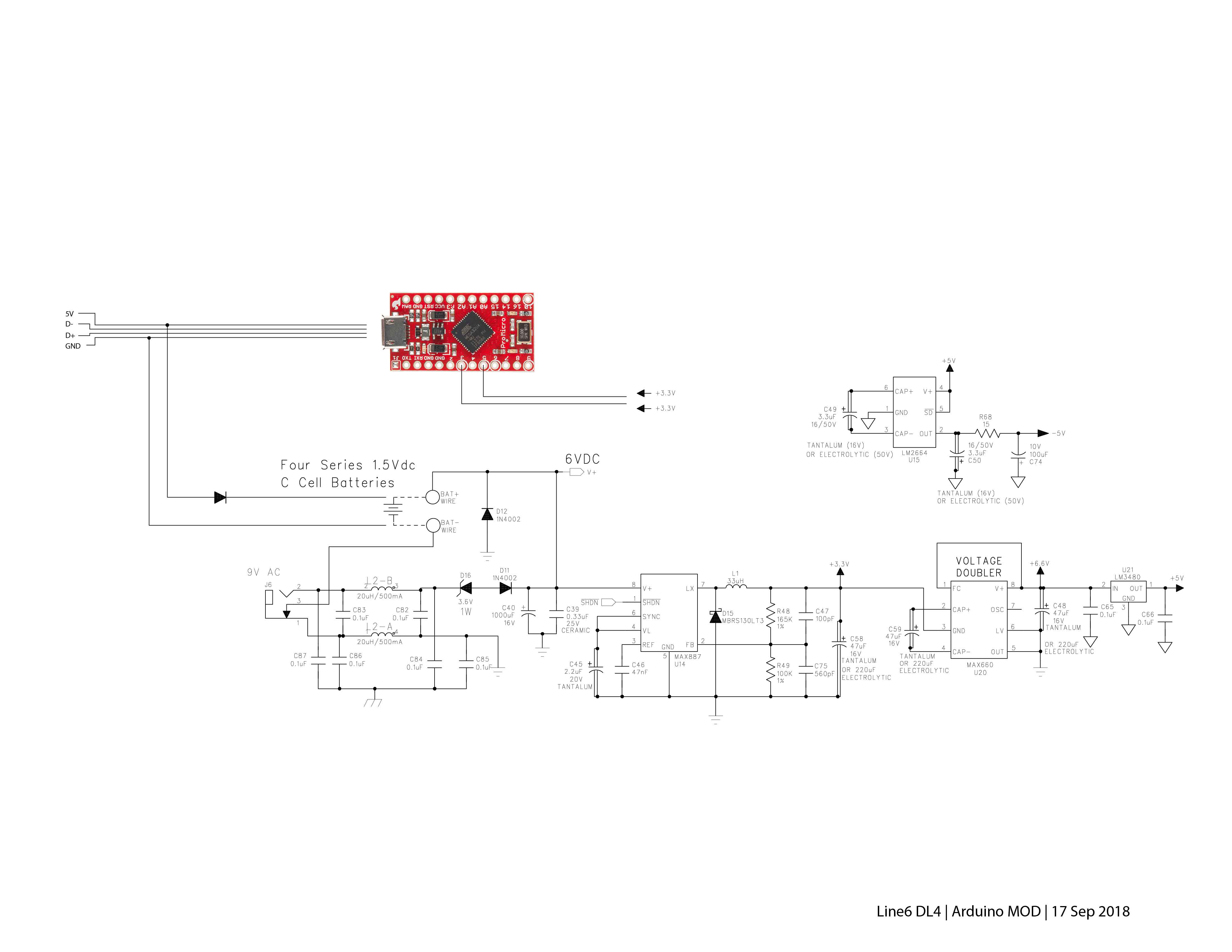

meanwhile here is my diagram. it's working fine.
the only problem occurs if I connect both the usb cable and the ac adapter. (even though the barrel connector interrupts usb ground). this happens regardless to the 5V looping through the amp. somehow:
groundless 5v from usb + 9V AC freezes the looper after half a minute of so...

meaning that the ac adapter barrel is brake-before-make type of connector (see diagram). i guess in order not to drain the battery
used the usb port from a unplugged laptop and the noise wasn't that bad. turns out the issue is more about ground loops rather than 5v filtering
Ah, sorry! I was thinking of an Arduino UNO, not your circuit (because this forum makes circuits difficult to see! :roll_eyes: ).
But you have it right - the grounding is generally the more important matter where there is a problem with interference.
