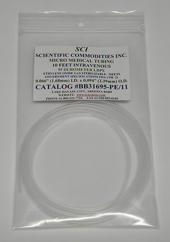

I will be turning strands of clear fishing line with Arduino-controlled motors, and even servos. One line per motor/servo. They are meant to be nearly invisible, with a piece of plastic glued to the 'other' end that will turn/spin.
But while fishing line is easily acquired in all kinds of forms, I need that line to be guided through protective 'tubes' as it makes it's way past sharp metal, to prevent rubbing. IOW, I don't want to show the...

You my friend are looking for clear PVC or polycarbonate tubing. They come in a huge variety of sizes thicknesses lengths, etc. You'll find what you need.

Thin IV catheters might be the right size. Medical supplies company.

Soft vinyl tubing like this has more friction than PEX. Unless the runs are very short with only a few bends I'd take a spool to the plumbing section and just rub it against various types to get an idea of the differences. It only takes a few bends to dramatically increase the pull required. It'd be a real drag - pun intended - to buy a bunch and then find out it's too hard to pull through your setup.

You could use PTFE Sleeving if you want a low friction solution.

Thanks for writing! This PFTE is the first thing I've seen small and transparent enough! I'm going through US suppliers now to ga few to have in the shop. Seems they are big in the '3d printing' circles, presumably for the rod material to pass through(?)...

  1. I'm only passing the clear fishing line through at most a 6" glass test tube, with vacuum tube guts in it. The idea is to drive a useless piece of metal, or propeller, or whatever super-glued to the end of the string from beneath via a servo or motor/gears). The only reason protection came to mind was that passing the line through a tube's sharp parts would not only be a poor guide, but also might rub against those metal parts.
It's just a doodad thing, along with LEDs, akin to this kind of engineering. :slight_smile:
  1. Today I went on a hunt for some test parts to see what the kind of dimensions I'm looking for are. I snapped these:
...and a little closer on the tube (3/32" OD & 60lb line):
Now this is not clear tubing, but it is a good size. I also grabbed an assortment of brass tubing, figuring they might even look better with a tube than a clear tube... The idea is to hide the fact that there is a mechanism from beneath moving the gewgaw, as if the tubes themselves were somehow making it rotate...
The 60lb line can be routed through most anything, including clothing or something it may be mounted on, to get to the turning device (motor/gears or servo). I'm really futzing around now with the visible parts. Because tubes are used (fascinating and mysterious as they are even before adding LEDs in them to younger folks), bending & soldering brass is no biggie.
