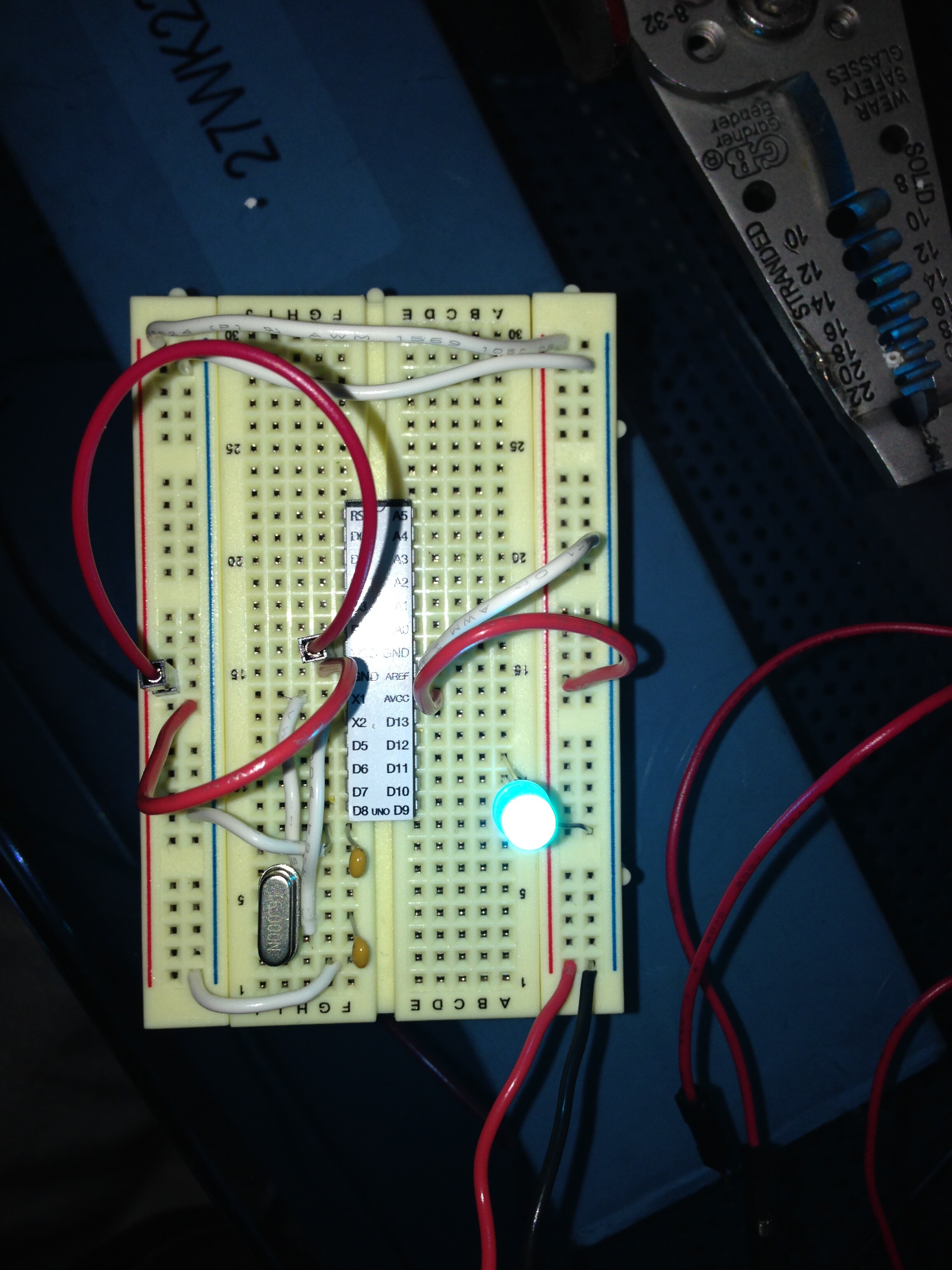

I'm working on transfering my project to a PCB, I have a couple atmega 328's with an arduino bootloader, I uploaded the program onto them using my arduino uno, and the program worked fine when i put the atmega in the uno, but when i took it out and stuck it on a breadboard using the same clock setup suggested by arduino's tutorial (http://arduino.cc/en/Tutorial/ArduinoToBreadboard) but the program is stuck, the LED should change color but it wont, and button switches are nonresponsive after the first time i use them which tells me that the clock must be malfunctioning somehow, any ideas?
My breadboard for reference
No bypass caps on your power connections, and no resistors for your LED, make for a particularly bad combination.
What value are the crystal loading capacitors? What happens if you just take them right out of the circuit?
the power supply im using is a switching 5v which i was led to believe eliminates the need for capacitors on the power lines, and as for the resistors to my LEDs the program running them is designed to keep the power input at safe levels to eliminate the need
and to jack, I am using 22pf capacitors and removing the capacitors causes it to not work at all

Often breadboard setups will run without the loading caps, but I still suspect the clock. Is there a datasheet for the crystal or link whence it came? Has a different crystal been tried?
No. Since you don't have a linear regulator, you don't need a regulator output capacitor to keep the regulator happy, but you still need "bypass caps" near the chip to help suppress short-term transients that happen when circuits inside the chip switch. Read one of the explanations for "bypass capacitors."
That doesn't work either. You can keep the power dissipation in the LED to reasonable levels by using short pulses, but the instantaneous current pulled from the chip during those pulses is still higher than the AVR is supposed to provide. These higher power output pulses PARTICULARLY cause transients on the pwr pins, which is why I said that the combination was particularly serious...

You definitely need 0.1µF bypasses all over the place, but particularly adjacent to the chip itself - even better than on the power buses on the breadboard. This is because at the frequencies in question, even relatively short lengths of wire have significant inductance. It is also a good idea to have something like a 10 to 47µF reservoir capacitor on the board (or breadboard), to account for transients.
westfw:
This refers only to the 0.1µF capacitor for high frequency stabilisation, on the regulator itself - linear regulators do not require any larger capacitor on the output.
As westfw points out, you cannot control the output current from the port by software - there is no means provided to do so.
