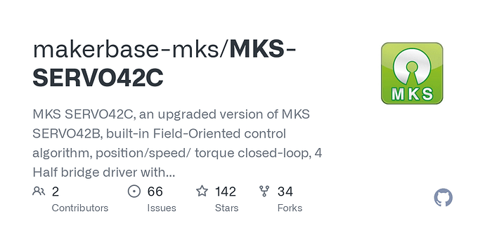

This special-driver of the MKS-Servo 42C can indeed report back torque
It looks like the MKS-Servo42C gives a measure of error between the steps called for and the steps moved:
command 4: e0 39 tCHK
read the error of the motor shaft angle.
Return e0, error(int16_t), rCHK.
The error is the difference between the angle you want to control minus the real-time angle of the motor, 0-FFFF corresponds to 0~360°, for example, when the angle error is 1°, the return error is 65536/360= 182.444, and so on.
Example:
Send e0 39 19
return e0 00 B7 97 (error 1 °)

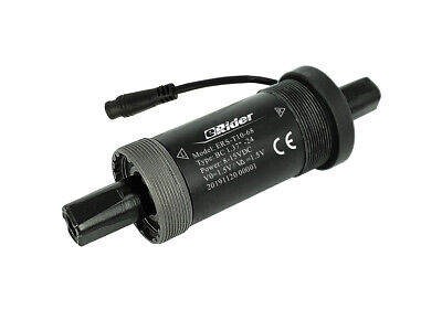

I would likely be looking at a rotary torque cell to sense the load and when the load increases do whatever you choose your motor to do. A rotary torque sensor for example will monitor your free running torque and if a load is applied the torque will increase and when it hits your preset limit you decide what you want to happen.

OK the MKS 42C has a "torque"-mode.
I found in the manual
Set the maximum torque (MaxT) parameter
command28: e0 a5 XX XX tCHK
MaxT value range (0 ~ 0x4B0). (Default 0x4B0)
Return e0 , result (uint8_t), rCHK.
result:
01- successful;
00- Failure
For example:
Send "e0 a5 02 58 df" (MaxT = 0x258)
return "e0 01 e1" (successful)

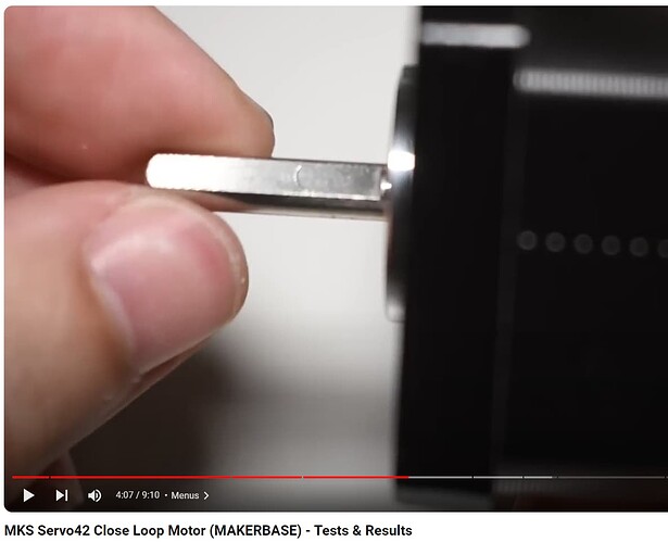

See youtube video I found and the torque test at 4:08.
https://youtu.be/R1TghZmE6Gs?si=YWmbIckQkNddJKTo&t=248

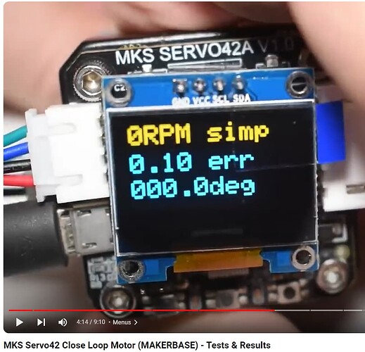

The video shows
If motor stands still = 0 rpm an a external torque is applied to the motorchaft the display shows the position-error
applying torque to the steppermotor-shaft
display showsposition-error
