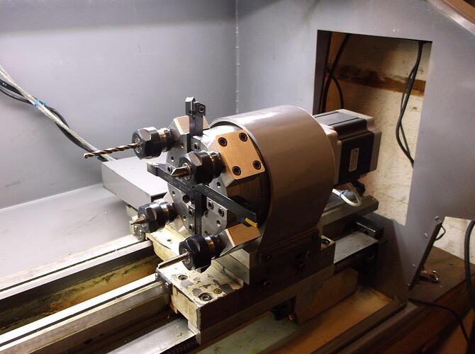

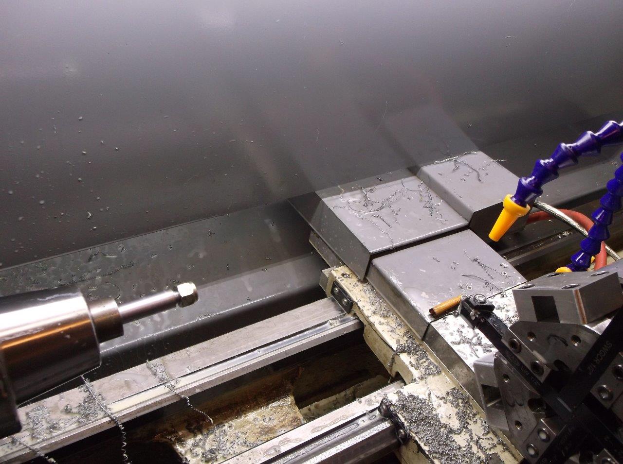

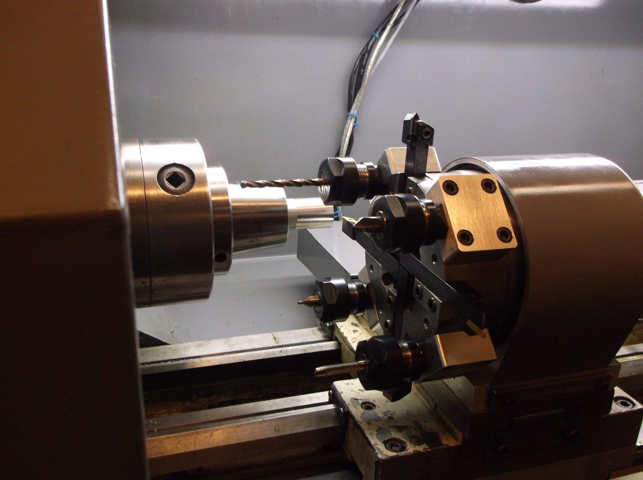

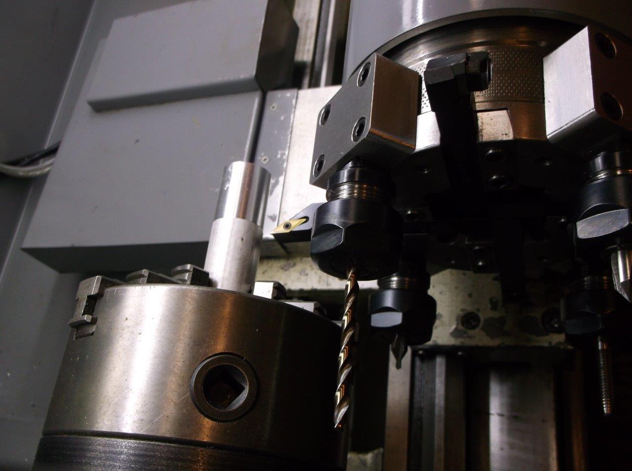

Here are a few pics of a tool setup and 2 different chucks.
I'll run calibration tests today

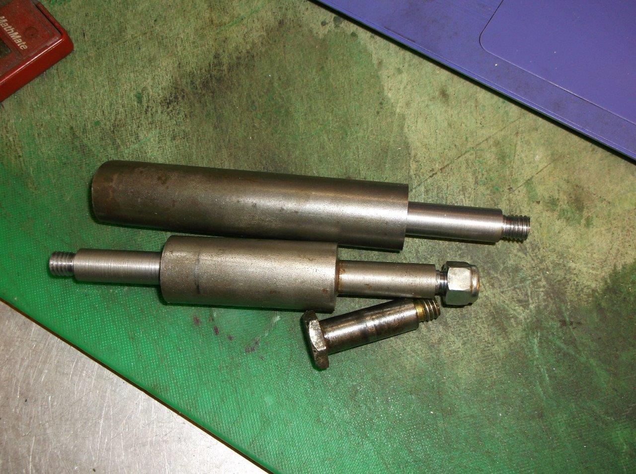

I was Testing the turret today and I made an axle bolt for my push mowers wheel.
I didn't need three, the video kept messing up so I had to restart 3 times.
