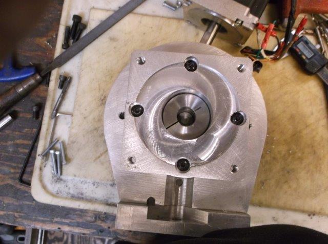

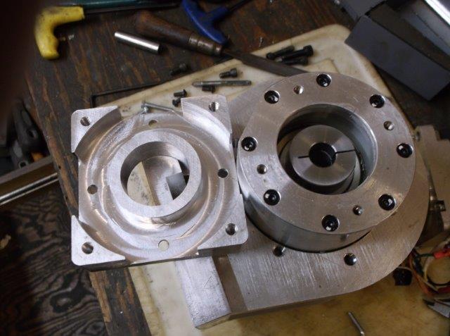

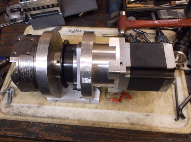

I am installing a new Harmonic drive into the system. If this resolves the change in tool position due to chatter then I may not require a change in the software. The drive is 100mm in diameter and the output shaft is 25mm. That shouldl be a huge increase in rigidity.

All testing was going very well and I made 8 parts that were holding accuracy of .001 or less.
The best I have done so far with this machine, just fantastic results.... and then I realized by chance that my used harmonic drive I purchased from Hong Kong has a bad spot in its gearing.
I have ordered a New harmonic drive now and I am at a standstill
