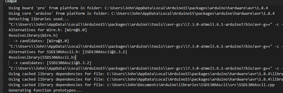

Tell the IDE to generate compile messages. Compare these between the two computers. You should be able to see the differences in resources used to create the uploadable code.

I'm not sure about you but the messages I see fly by so fast I can only catch snippets as they zoom by.
Below is a snapshot of what I am referring to. Every library and every path is identified. If there is a difference then you will see it. If there is no difference then you will have a list of components that you can delete from your computer and re-install.
If you have a Windows machine then the path to much of the Arduino resources is normally hidden. For me the path is :
C:\Users\John\AppData\Local\Arduino15
If I had your problem and no success to date I would:
  • Uninstall Arduino IDE
  • Backup then delete the Arduino sketch directory (this will include the libraries)
  • Delete the Arduino15 folder. This is an important step.
Reinstall what you need.
