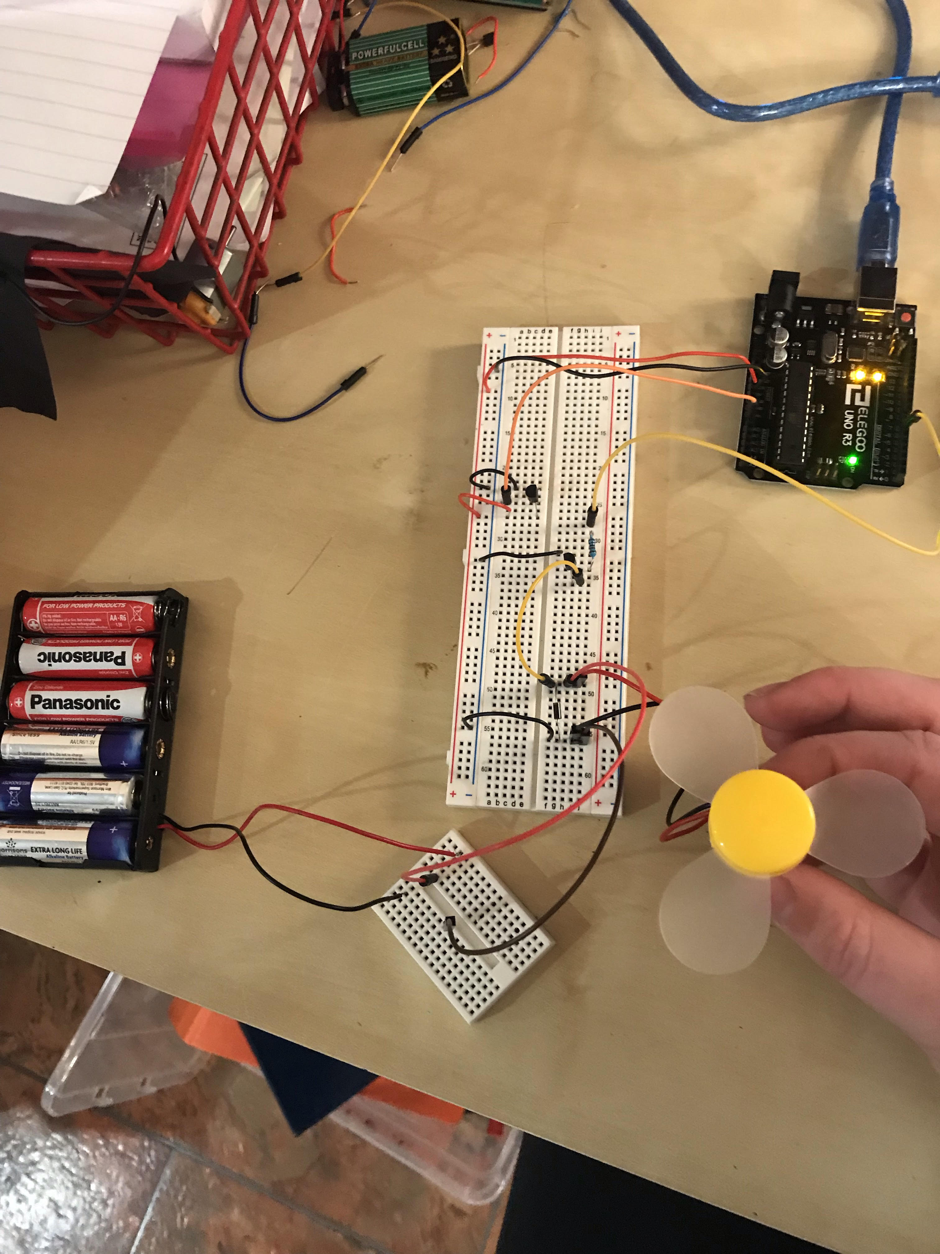

OP's image:
Please post a hand drawn wiring diagram (not Fritzing). No one can make sense of that photo.
Do you have a motor driver? The Arduino cannot power ANY motors or servos.
Why isn't the fan turning off below the tempMin value?
We have no proof that it isn't. Your Serial output is missing from your post.
Some Serial.print() statements in the if blocks would be useful, too.
Double check your wiring/circuit, specifically the fan side.
I'm not quite sure what circuit you're trying to implement there, but whatever it is, it's not correct. You are essentially just plugging the fan into a power source.

This is the wiring diagram i was working off of
Did you connect all the grounds?

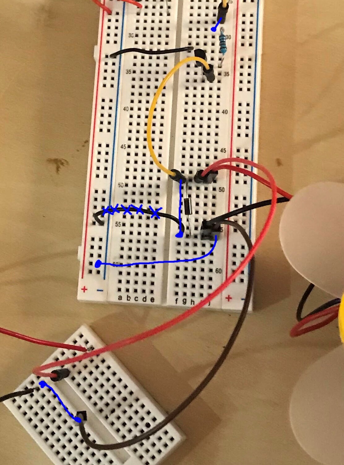

Your circuit (as per the last photo) is wrong.
This is how you have wired things up
Note: The earth from the Batteries is not actually connected to anything.
I'm surprised that the fan even turns
I've added some blue thingies to your 'photo, indicating where the wires should be moved to.
Just make sure you disconnect the red wire from the battery before making the changes.
Once the new wiring arrangement is okay, re-connect the red wire.
I am making the assumption that the NPN and temperature sensor are correctly wired.
I am also making the assumption that the stripe on the diode is closes to the red wires.
The wire marked with blue crosses should be removed.
