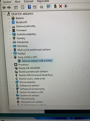

The device-manager of windows.
if you click on the windows icon there should apear a textfield
type there device-manager
Okay i found it, what now ?
I already wrote it
best thing is make a screenshot and post the screenshot
No if you look into the arduino IDE you should be able to choose COM5
It is there ofc, but i meaned that i dont see the port in ,,This computer” on you PC you know ? Like if you connect a flash drive
