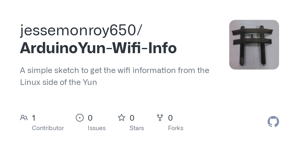

Hey All,
this is the first of many upcoming troubleshooting tools. Some of the issues with the Yun, we see over and over again. This first sketch will get some basic information. If you have an issue or you see someone in the forum, point them toward this sketch. As we gather facts for this, I'll add notes to the wiki part of github for this.
Here is the URL for the sketch. Feel free to make a pull request to make changes you would like to share in this sketch.
A note on operating the sketch: after you start the sketch it will take a second or two to start outputting information. It will get
  • time of day
  • list of APs
  • the wifi radio configuration
  • the default gateway (to the internet), if any

Updated the code to return an IP number for the gateway and not the name. --Jesse
