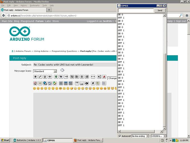

Thanks for the reply, yes I did mention that UNO has only one Serial, anyway just now I loaded the same with some changes to removed the Serial1 thing for UNO, please see attached output, I am using just the Serial Monitor.

In Leonardo the only output seen in the Serial Monitor is the Switch output not with the Encoder, please see attached screenshot.
